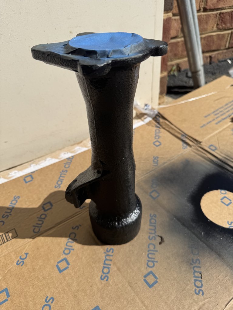

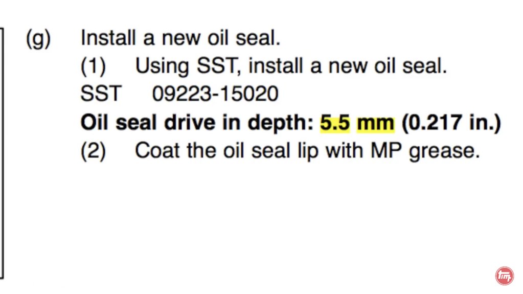

    Yes i have it saved as a favorite on my phone haha. Its 5.5mm

    I am selling a diff tube without ADD. Im not sure if you would need to replace the internal parts though (i bought a whole diff and tube, that already had the internal parts that i needed). You definitely just need the shorter bolts and a new seal.
    let me know if you're interested

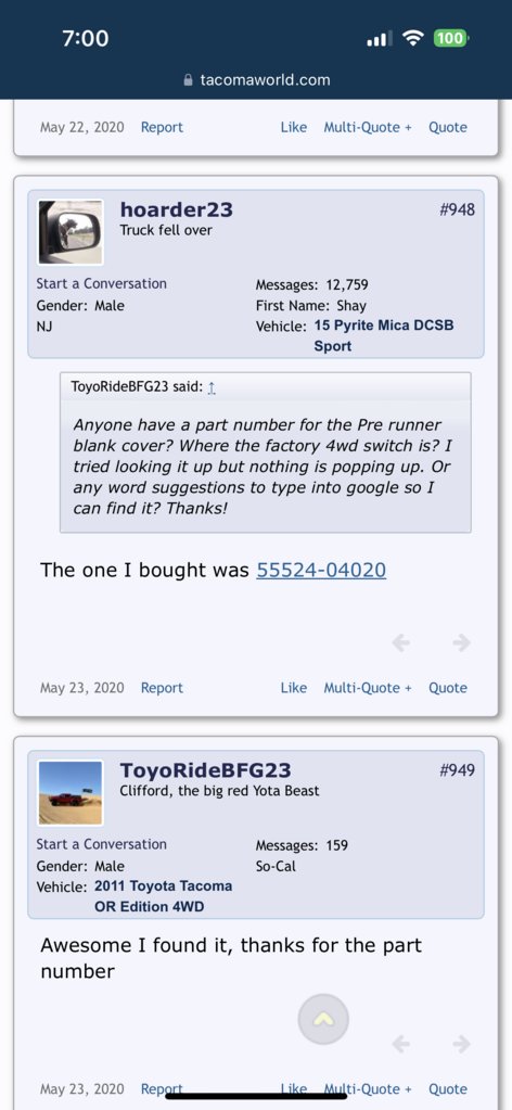

    Last part to my puzzle! Oh, and the prerunner selector cover for the interior is $22. So Ill be waiting on that.

    Wouldn't happen to have the part number for that PreRunner selector cover by chance? I have all the parts for the tube and a twin stick FJ converted on the shelf. I am going to try and knock all this out at once. I have some new parts in development for testing and need to get this part setup first. More to follow...
