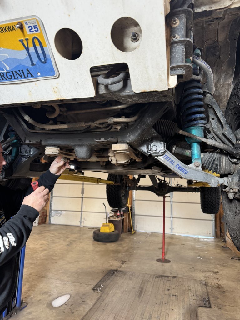

  17. Jan 12, 2025 at 12:59 PM
    #457
    fatfurious2
    Jun 28, 2014
    #132884
    49,725
    David
    Ashburn, VA
    2010 TRD OR Access Cab
    So we didnt have to pull the actuator. I had some help, but i didnt know which pins they touched to get the fork to slide over. Took more time to put it on the lift :rofl:
    Got my 4wd back!
    Littles and CygnusX191 like this.
