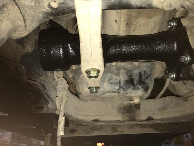

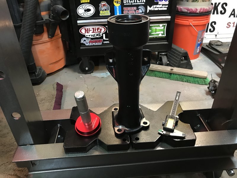

    I deleted the A.D.D. by welding the clutch sleeve to the hub, in the engaged position. I reused everything, nearly free mod.
    I removed the 4 star bolts, tube came right off. You can remove the components from this same end, no need to remove the shaft from the tube. Once you slide the hub and sleeve out, place the hub within the sleeve on a flat surface and weld. Easy day.
    I sealed and covered it with an aluminum plate.
    Sold my actuator on the forum.
