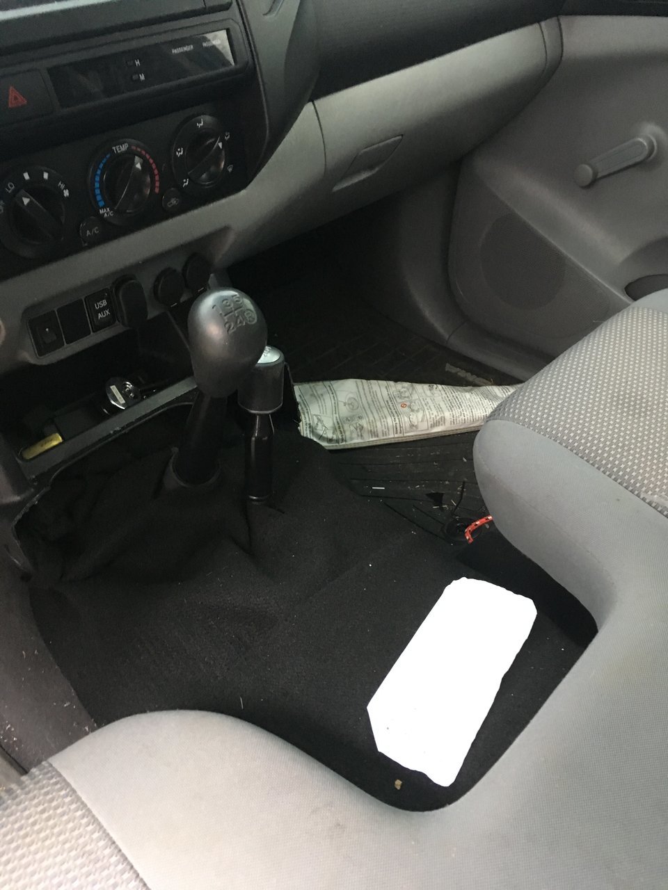

    Finished mine over the weekend, a little aesthetic work may be needed but overall I’m super happy with this. The switch next to the usb/aux tab controls my add, I’ve honestly just left it locked I can’t tell a difference driving it this way.

    Looks good. I can’t tell a difference either. Another reason I went ahead and just did the FJ tube.
    IMO, doing the FJ T-case swap, and not doing the tube, takes a simple process and complicates it. Now, I just shift. Simple & no actuators to fail.
