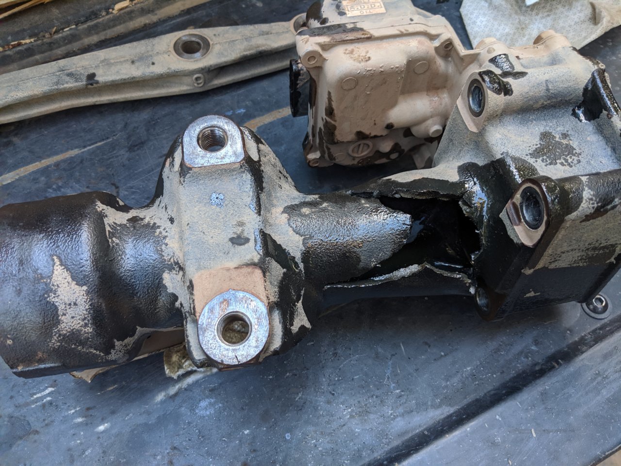

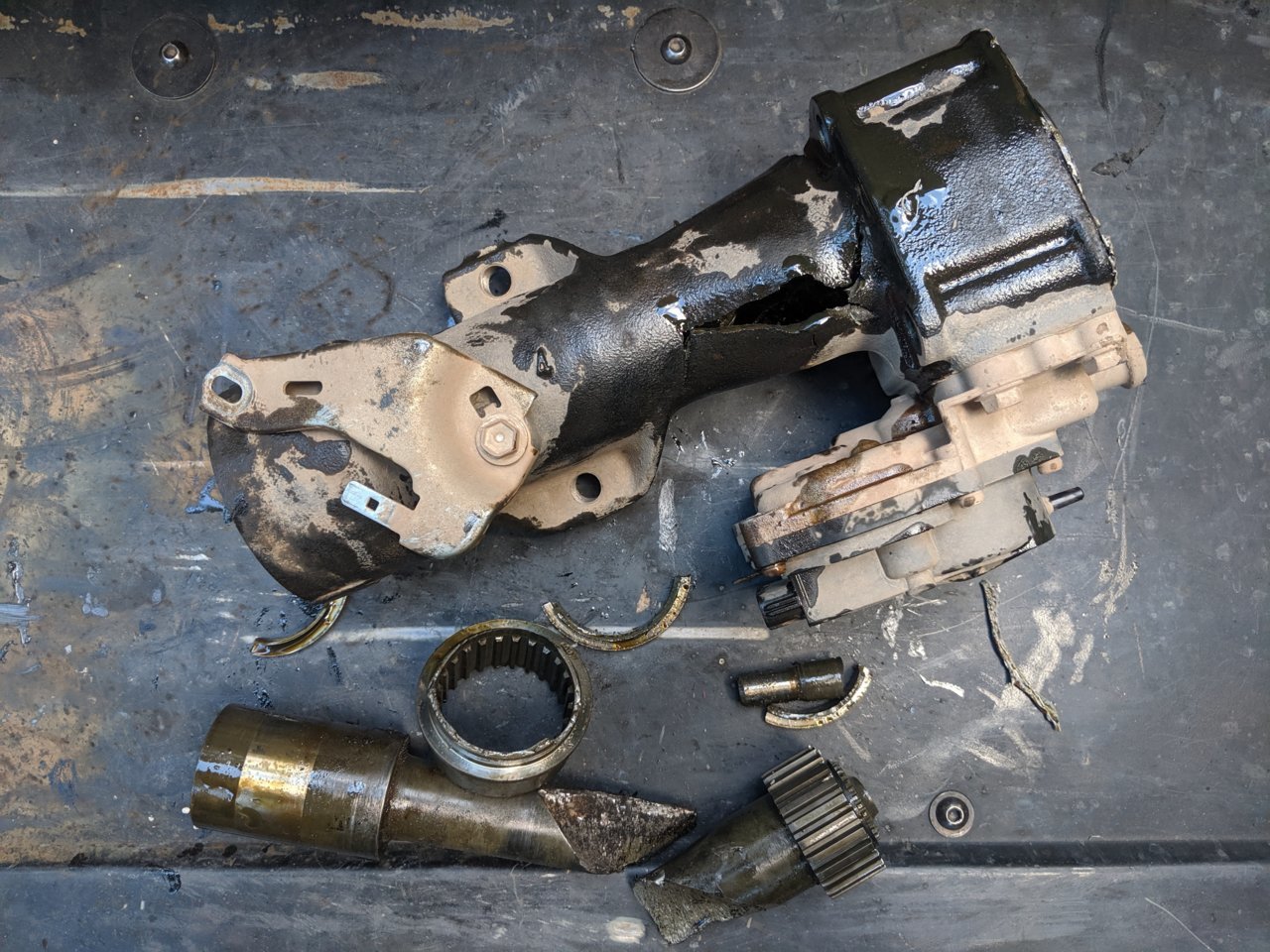

    How many people have actually broken an ADD shaft? I've only seen reports of 2 failures and a rumor someone else broke one in snow.

    I’m the only one I know of, I’m sure plenty of others have though. It’s the fuse of the modern Toyota 4x4 system.

    I'm curious how many have failed, I worded my previous post kind of weird, you and I are the only ones I've actually seen break one.
    Your failure is odd, as far as everything I've seen the birfield spline shaft should fail way before the ADD shaft. I wager a buck yours had a manufacturing defect.

    that could be. I was thinking the same thing once I got everything fixed up. Even if the shaft itself hasn’t failed it’s much simpler to rid yourself of the electronic BS. one actuator will cost you the entire FJ setup. I haven’t had any problems since but also haven’t gotten my front end in that bad of a bind since then.
    I think more people are swapping to this setup to rid themselves of the electronics vs replace a broken half shaft.
