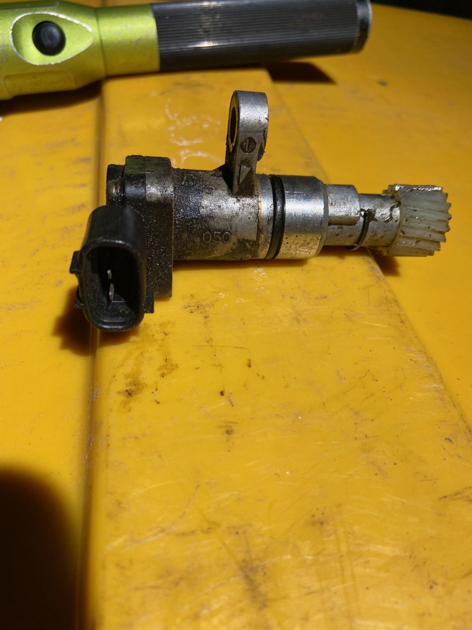

    I know it's a little off topic, but since FJ transfer case is a close or relevant topic to the ADD. You guys know if this VSS would work to relocate it from the rear axle?600664531.jpg found this for sale from a 96 Taco 4 cylinder, guess it says 13/ 28 on the plastic gear

    If you are an autocraptic yes it’ll work. You’ll have to do some rewiring in the glove box area to tie it in to the ECU. As far as if that specific sensor from an older taco will work I’m not sure, I’ll check my bolt pattern tomorrow when I head into the shop, I have my case dropped for a clutch replacement. Are there two wires or three in that connector?

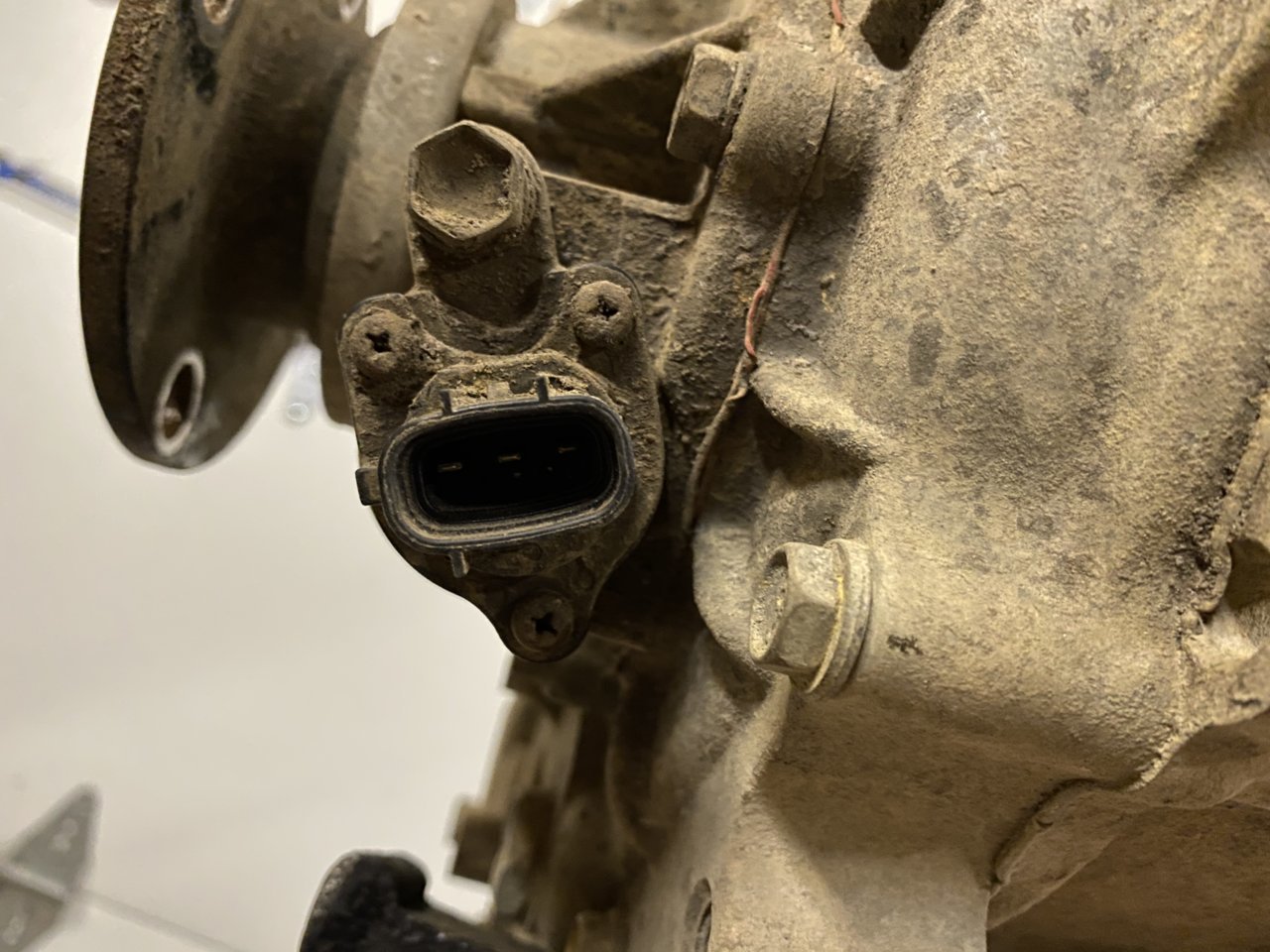

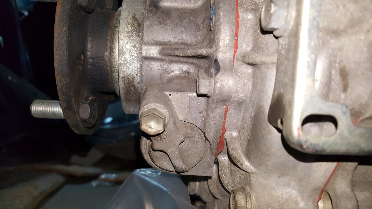

    Yes. the manual transmissions for the 2nd gen taco uses 3 pins, ignition switches voltage supply, ground reference to the instrument cluster and one wire for feedback pulse signal to the cluster. 4 pulses for every one revolution of the speed sensor. Looks like the one from the older taco won’t physically bolt up

    The FJ case and the tacoma case use the same for the VSS. My case is from an FJ cruiser. The speed sensor you have looks like a different size from the picture but it's hard to tell. Plus if that sensor you have only has 2 pins it won't work in the 2nd gen tacomas
