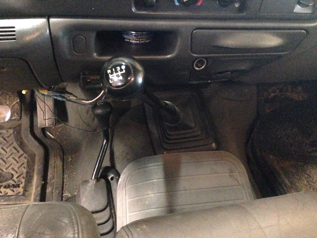

    @clupi heres my other rig, I enjoy driving this one even more than the taco. Plus it comes from the factory with manual hubs. What was Toyota thinking catering to these folks who want to push a button and teleport through space via 4wd?

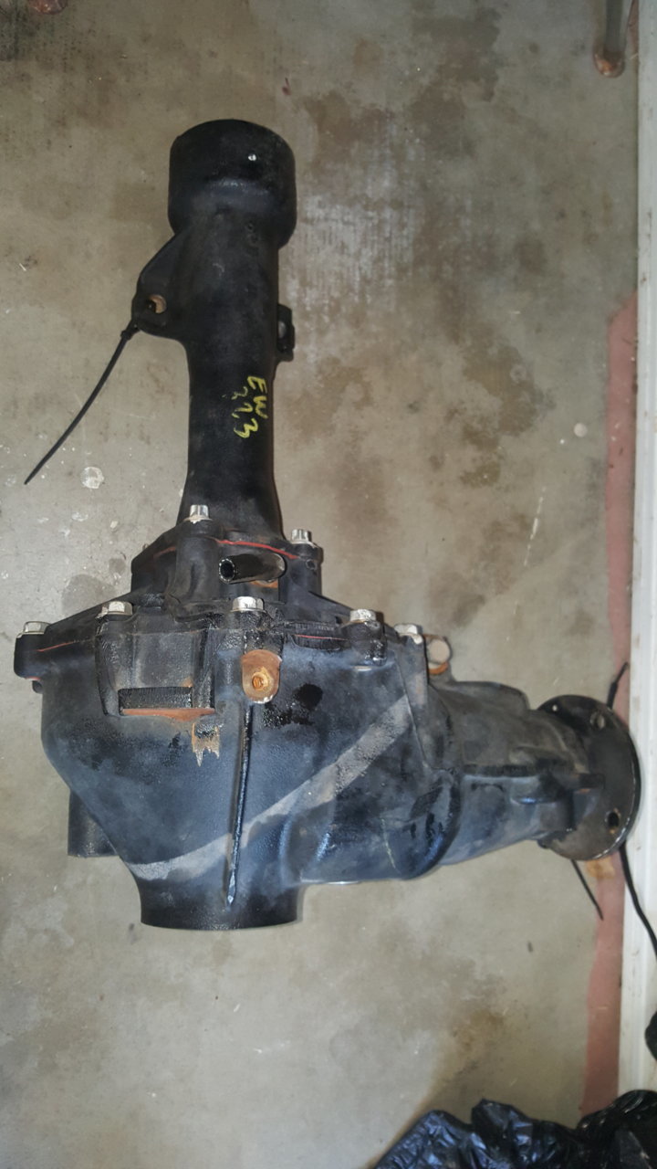

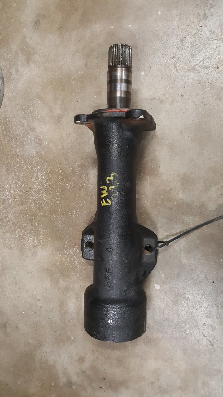

    20200131_161254.jpg how much you think the clamshell is worth?
  10. Jan 31, 2020 at 9:40 PM
    #150
    6 gearT444E
    6 gearT444E Certified Electron Pusher
    Feb 3, 2018
    #243372
    7,770
    Deep South
    Herculiner Hootus
    nice. I’d say maybe 250-300 if it’s stock gears with relatively low miles.

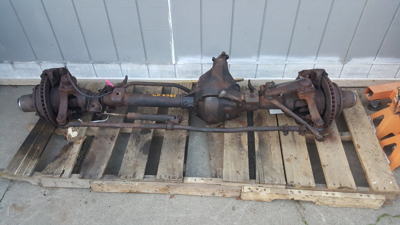

    Yes, thanks.. I put it up for sale on local CL! Its got 95k with 3:91 (fj stock gears) so hope I sell it. Was thinking of keeping it and building another 3rd for my Taco, I'm 4:88's but not locked up and keep my current diff as spare but eventually I'd like to do a strait axle. Thanks 20200124_164343.jpg found another 79 ford 60 which I guess is the ultimate Add delete :) ... just a little at a time unless I get a sponsor

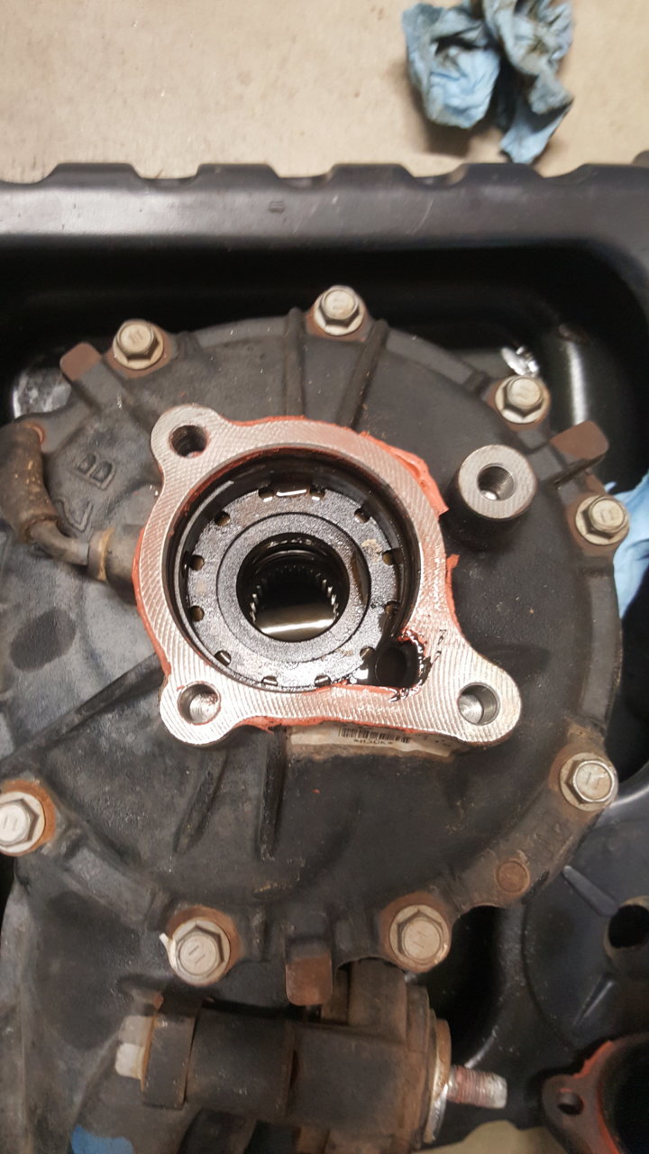

    Any tips for getting the add stub shaft out? I’ve been going at it for an hour and it won’t budge
    nevermind i got it.
