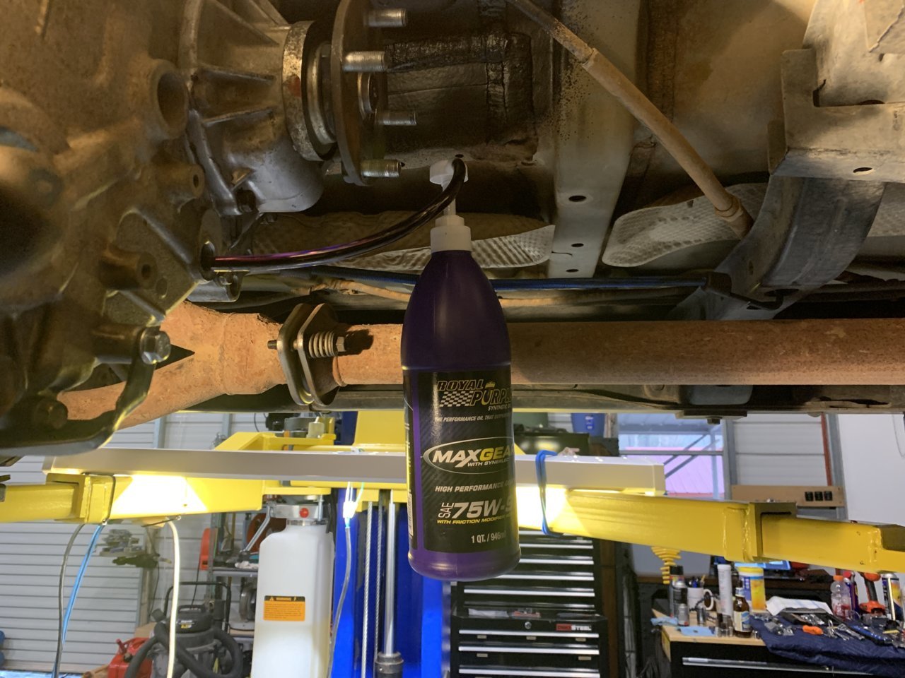

    lil tidbit for when you're refilling the diff, loop a bungee cord through the handle and hook it to the frame. You want the cord to be fairly right, but only enough to pull the pump up against the frame. It's way easier to push the bottle upwards, the weight pulls it back down, and you can fill the diff one-handed. This should work just the same without a lift if you hook it in the right place.
    This pic is of the t-case, but it works exactly the same for the diff.
    I filled the xfer case with a beer in my other hand.
