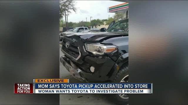

    Tell this poor mom it's normal. :angrygirl:

    This transmissions behaves like shit when it's cold. You pretty much have to keep the brake pedal smashed into the floor until it gets warm. It's not hard to believe that someone ran into something.

    Just don't be like that woman who ran into a wall.
