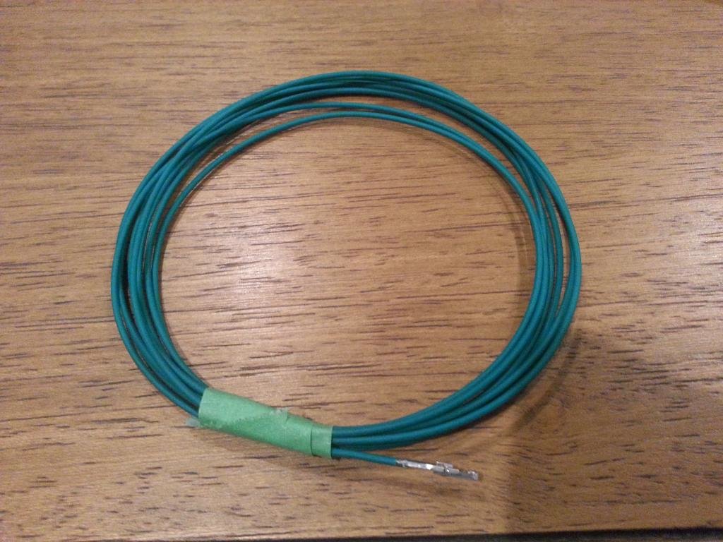

    If you are adding the feature, you need to contact Bob and have him send you this:

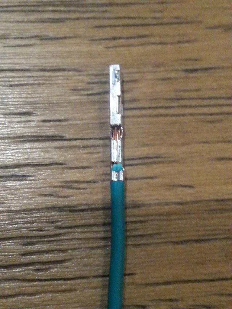

    Note the contact on the end of the wire:

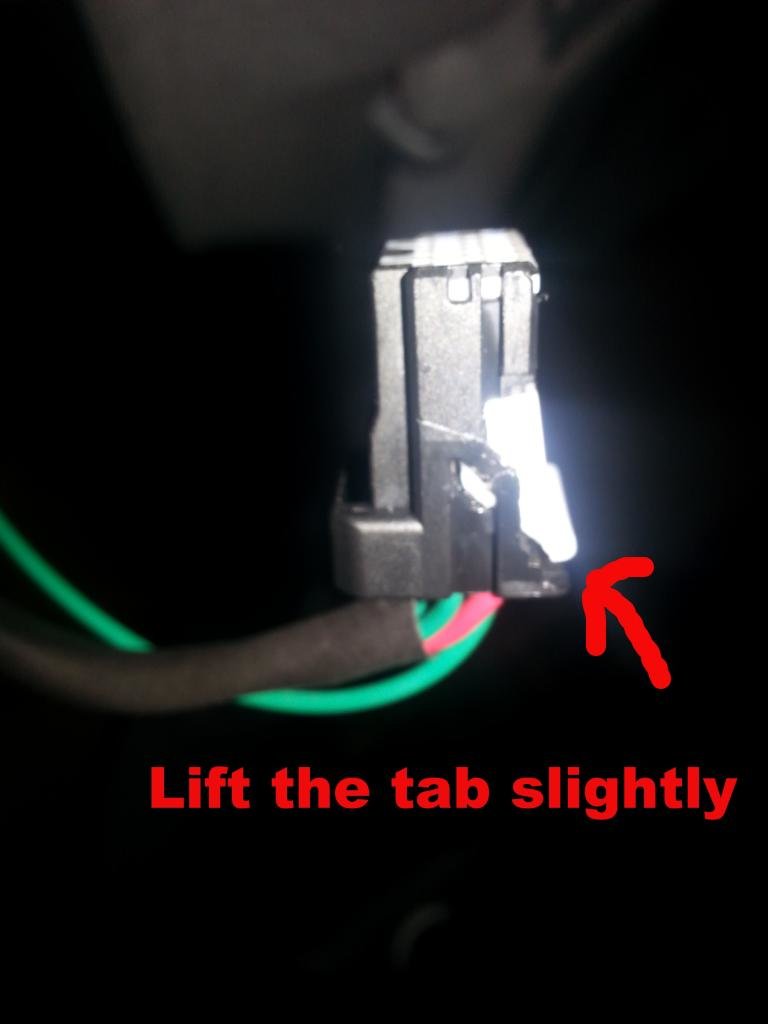

    Unplug the connector on the back of your mirror and slightly pry up the secondary lock mechanism (AKA: the white tab thing). This will allow you to insert the contact into the connector. This part is tricky. I found it only needs to be lifted a small amount (about 1/32” or so). I was having difficulty getting the contact to slide in and I found I had the tab lifted too much.
    fff09f0a-6f46-482e-9828-34a5417aedf9_zps_5bb86749e051f80fb277dfa5c69976244d01d372.jpg
    With connector oriented to have the white tab on top, the contact is inserted with crimped side up (see above picture of the contact – that side up). The contact should be inserted in-between the red and black wires. The contact should slide in smoothly and you should feel a slight click when it locks in place. If you are feeling resistance, don’t force it. Try to wiggle the white tab a little while trying to insert the contact. After you get the contact inserted, push the tab back down to fully lock the contacts in place. It should look like this when you are done. (The green wire is the one I inserted).

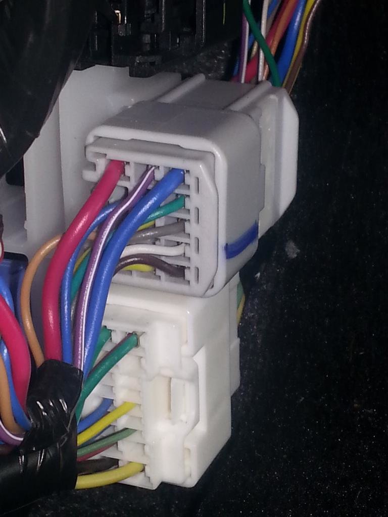

    Locate connector ID2 (as Toyota calls it). It is the grey one shown below.
    53a98d7e-d049-417d-9773-8418d1b7153f_zps_6bae5a1754b0c4bbb2bee2f257fb50af41e56be1.jpg
    Here is another picture:

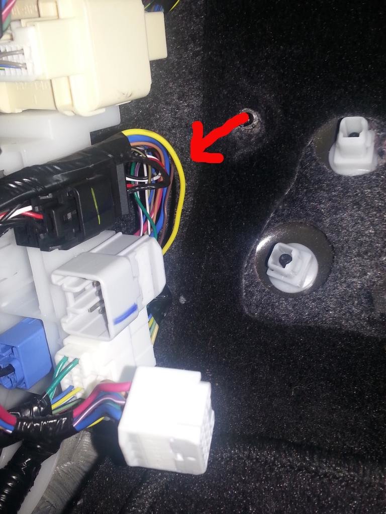

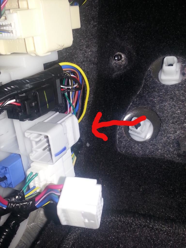

    From here you have 2 options. You need to tap into a wire that has 12 V on it when the vehicle is in reverse. Pin 1 of this connector (the big thick red wire) feeds directly to your backup lights. Pin 7 (the solid yellow wire) feeds the trailer backup lighting circuit. I chose the yellow wire as I thought it was a safer option. Here is a better close up of the wire.
    d5dc47fc-e7a0-47cb-b64e-67a9843adc04_zps_09d2e18c52bbb58d37d88f90f872cdae010d1e29.jpg
    Whichever one you choose, just simply tap into the wire using your preferred means (butt splice, tap, solder, etc) and connect the green wire from the mirror.
