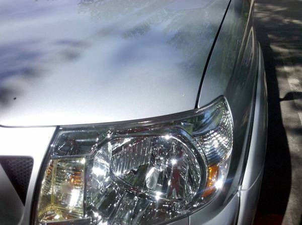

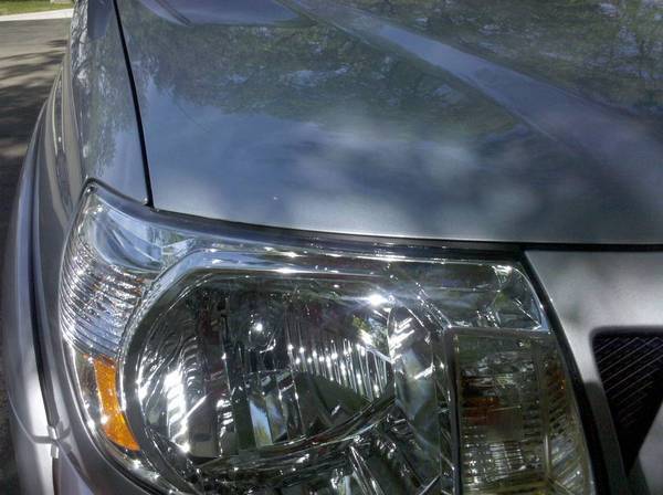

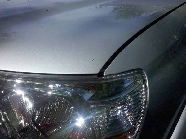

    If your hood doesn't line up (the spacing on either corner relative to the height away from the headlight assembly there is a simple fix.
    see the difference? look closely as its kinda hard to notice....

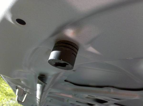

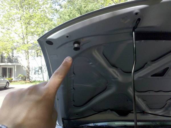

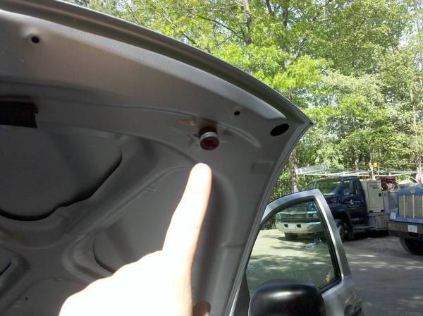

    well to fix this, simply pop your hood, and locate the little rubber washers located on either corner of your hood
    once located, you can simply rotate these with your fingers clockwise or counterclock wise until you think youve reached the proper alignment.
    (Hint: the further the rubber sticks out from the bottom of your hood, the further your hood will be off your headlight)
    now to do this i had to open and close my hood a few times until it was perfect, which was annoying, but the end result is AMAZING....
