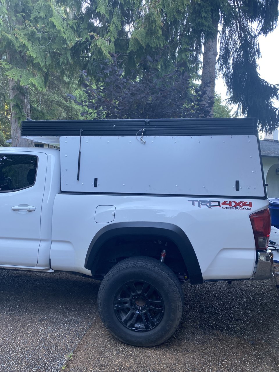

    Almost done

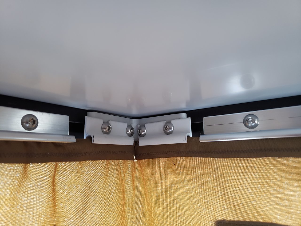

    More progress. How is everyone handling the corners with the tent.

    @2ski4life7 Ordered some awning track from sailrite. Cut them to size and slipped them in between the screws and L-brackets. If you do this, be careful not to fully unscrew the screws from the T-nuts because its a pain to screw them back. Also, I only did this for the upper corners and front upper corners of the tent. Still figuring out the bottom corners. 20210714_192543.jpg

    I believe @CayucosTacoma 3D printed a bracket that goes in the corner
