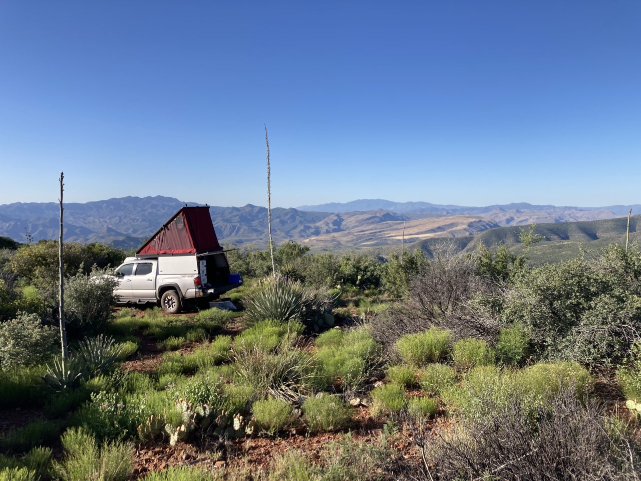

    Almost 3 years now and still going strong! One of many incredibly remote trips we wish lasted longer. This is just south of the Sierra Ancha Wilderness in AZ.
    https://www.tacomaworld.com/threads/composite-80-20-wedge-camper-build.681480/
    Still need to take it off and seal it up (meh, it never rains in here). I promise I’ll do that this summer and give a good inspection report on damage/cracks/wear.
    Very happy with this build and happy to see other people still tinkering around with their custom tents. Keep it up! I don’t think a prefab would have brought me the same joy.

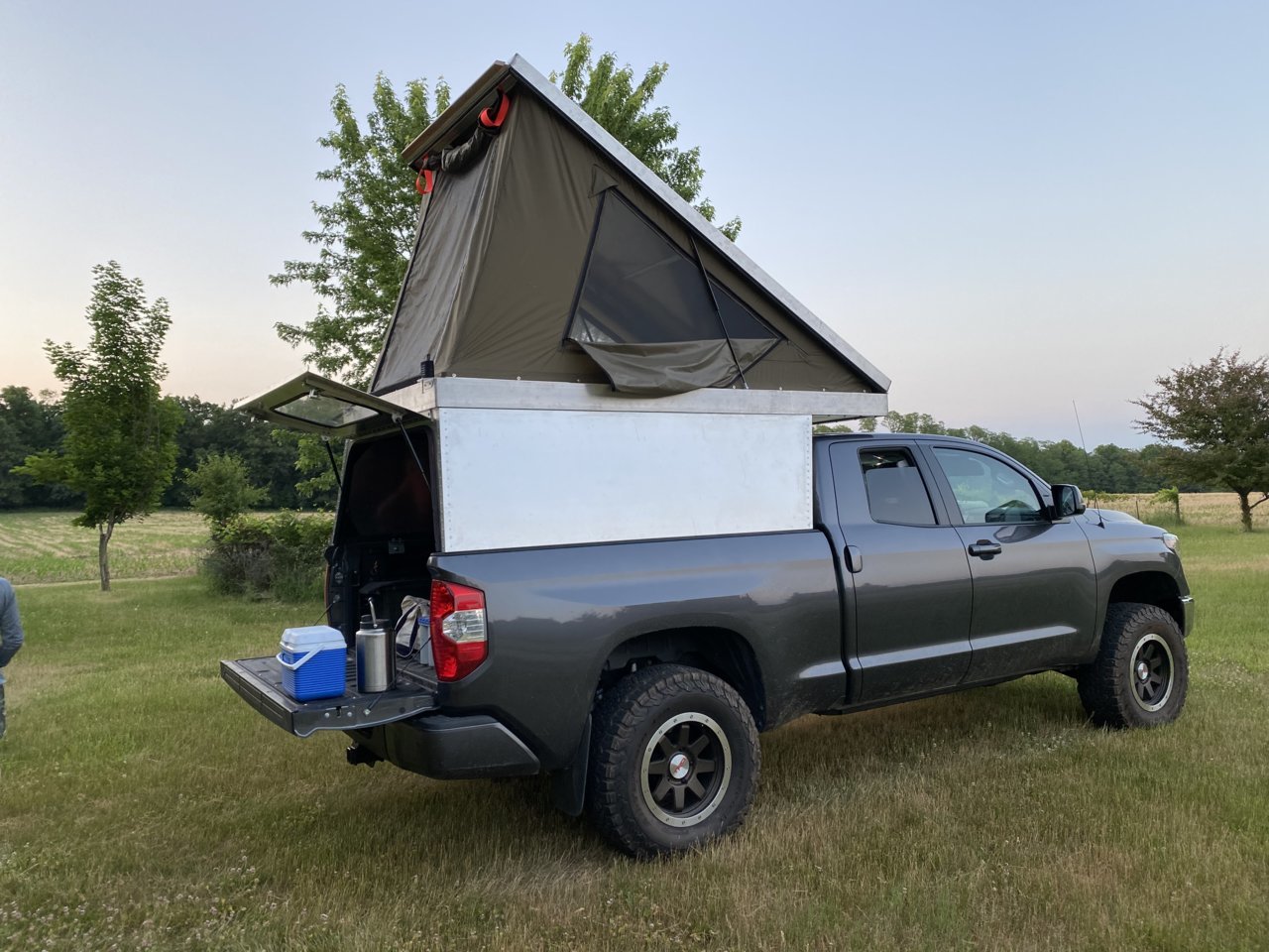

    Finally all sewn up.
    Hopefully get it on the tundra this weekend.

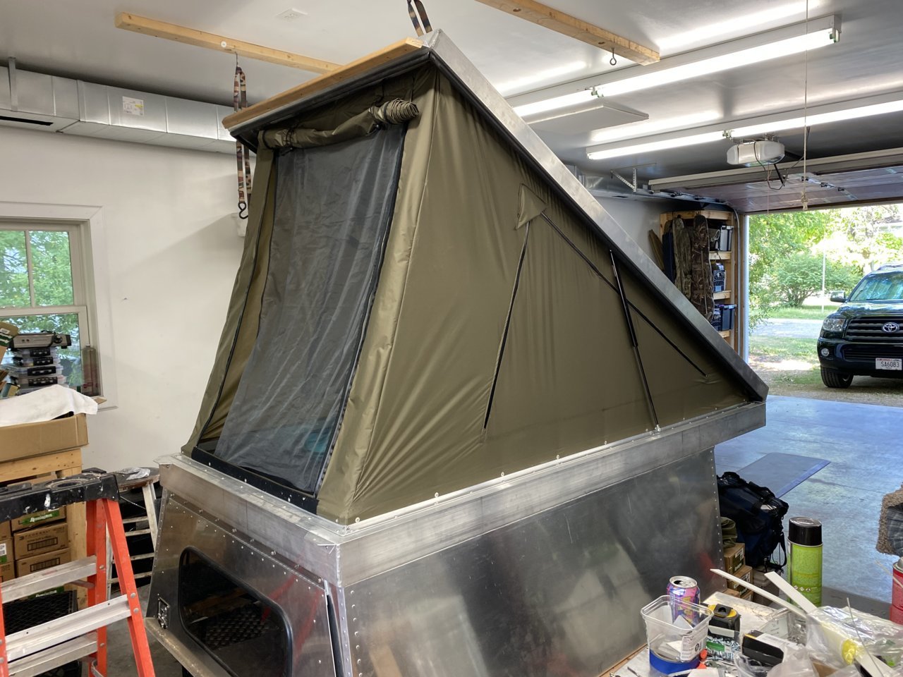

    Again, not on a Tacoma, but she’s finally done.

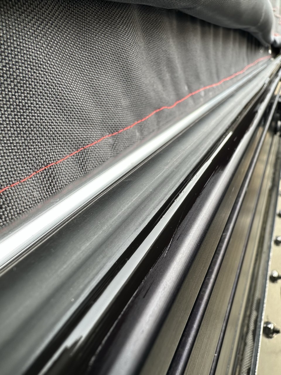

    I can’t keep water out of this thing. I hosed it down while it was closed. Looked inside…no water. Came back 30 minutes later and there’s a huge puddle inside. Water is somehow filling up the 80/20 and slowly seeping through. I’ve used so much silicone and I can’t figure out where the water is finding it’s way in.

    Did you silicone between the bulb seal on the 80/20 and the 80/20 itself?
    If you spread a super thin bead along the outside edge of the bulb seal and the 80/20 extrusion that's where mine was coming in. Same symptoms and delayed dripping.

    Thanks for the suggestion. I already did this and I’m still having the same issue.
