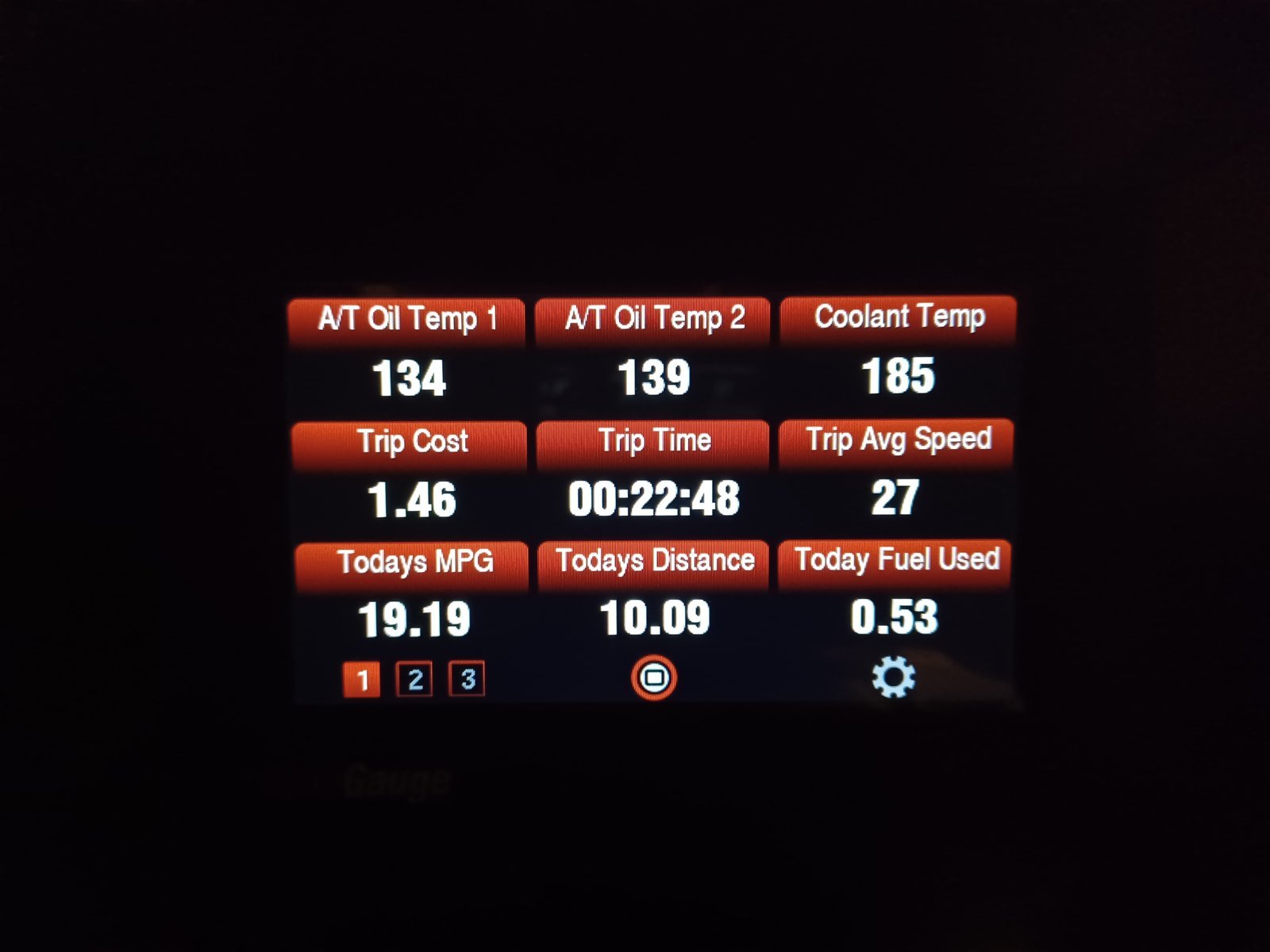

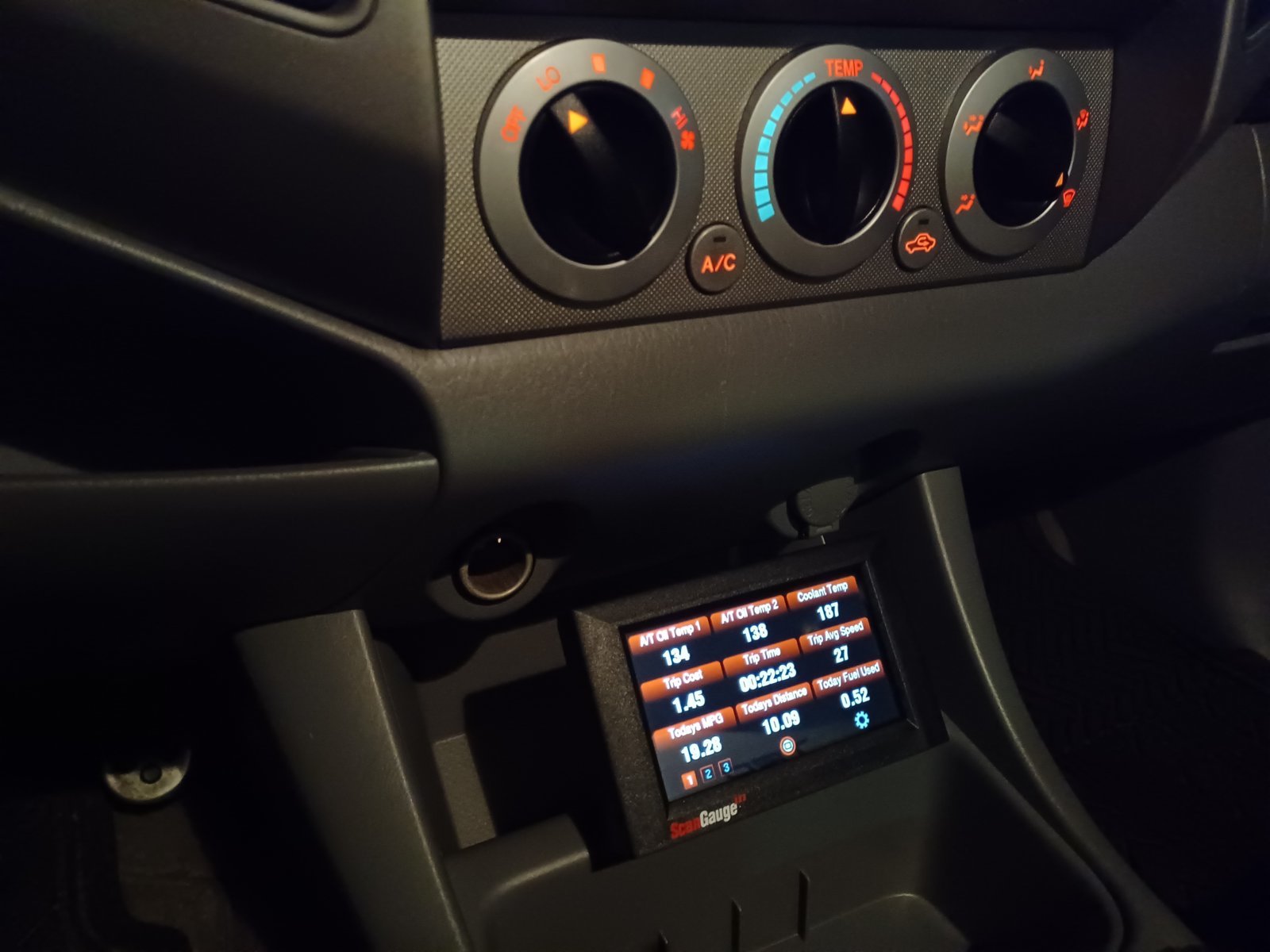

    Did the drain and refill of my transmission fluid today using the new Scan Guage 3
    Pulled the level check plug at 112F on the pan temp. She shifts perfectly! Mounted it up using an aluminum bracket I fabed up.
    Definitely liking the new Guage

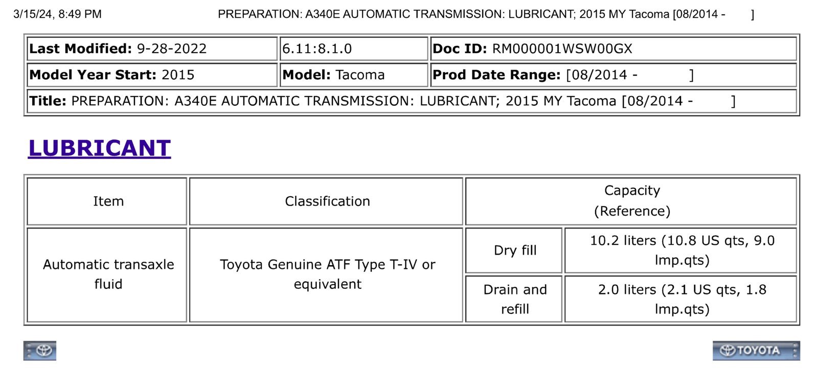

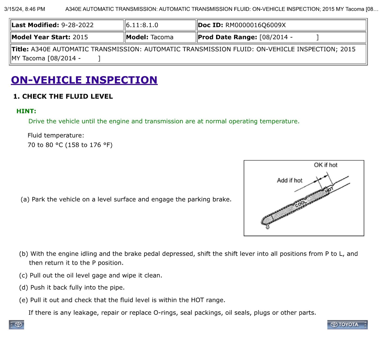

    I've got a 2015 prerunner a430e (dip stick)
    Since its not the electronic trans (iirc) the temp check thing isnt necessary correct?
    So just drain it when warm (30 min after a drive?) And fill new fluid the exact amount that came out - fire up, shift thru gears, check the dip stick - add if necessary?
    I've looked all over here and the interwebs and it all comes back w the 2 plug trans w the temp check bs... so wana make sure I'm gravy. About to drain and fill tomorrow
    wmb67 likes this.
  16. Mar 15, 2024 at 3:13 PM
    #2216
    Micbt25
    Micbt25 Well-Known Member
    Jan 12, 2020
    #315844
    594
    TM
    2015 MGM TRD Sport Access Cab 4X4 V6
    If you have the 4 cylinder then I believe you have a dipstick so it doesn’t use WS and you do not have to perform the temp check, if you have a 6 cylinder (4.0 liter) you have to do the temp procedure or have a scan tool that shows the transmission temperature, and then perform it that way.
    Burritopa[QUOTED] likes this.

    Yeah its a 4 banger. I guess I'll find out the hard way tomorrow. Weird how theres almost no common info out there on these spcifics
  18. Mar 15, 2024 at 6:52 PM
    #2218
    Dm93
    Dm93 Test Don't Guess
    Mar 3, 2015
    #150066
    12,909
    Texas
    2014 DC OR 6spd 4x4
    Predator tube steps, Ranch Hand grill guard, Magnaflow CatBack exhaust, Toyota tool box & bed mat, 2LO Module by @Up2NoGood, Rearview Compass/Temp Mirror, Tune by @JustDSM.
    Procedure for the A340 Trans.:thumbsup:
