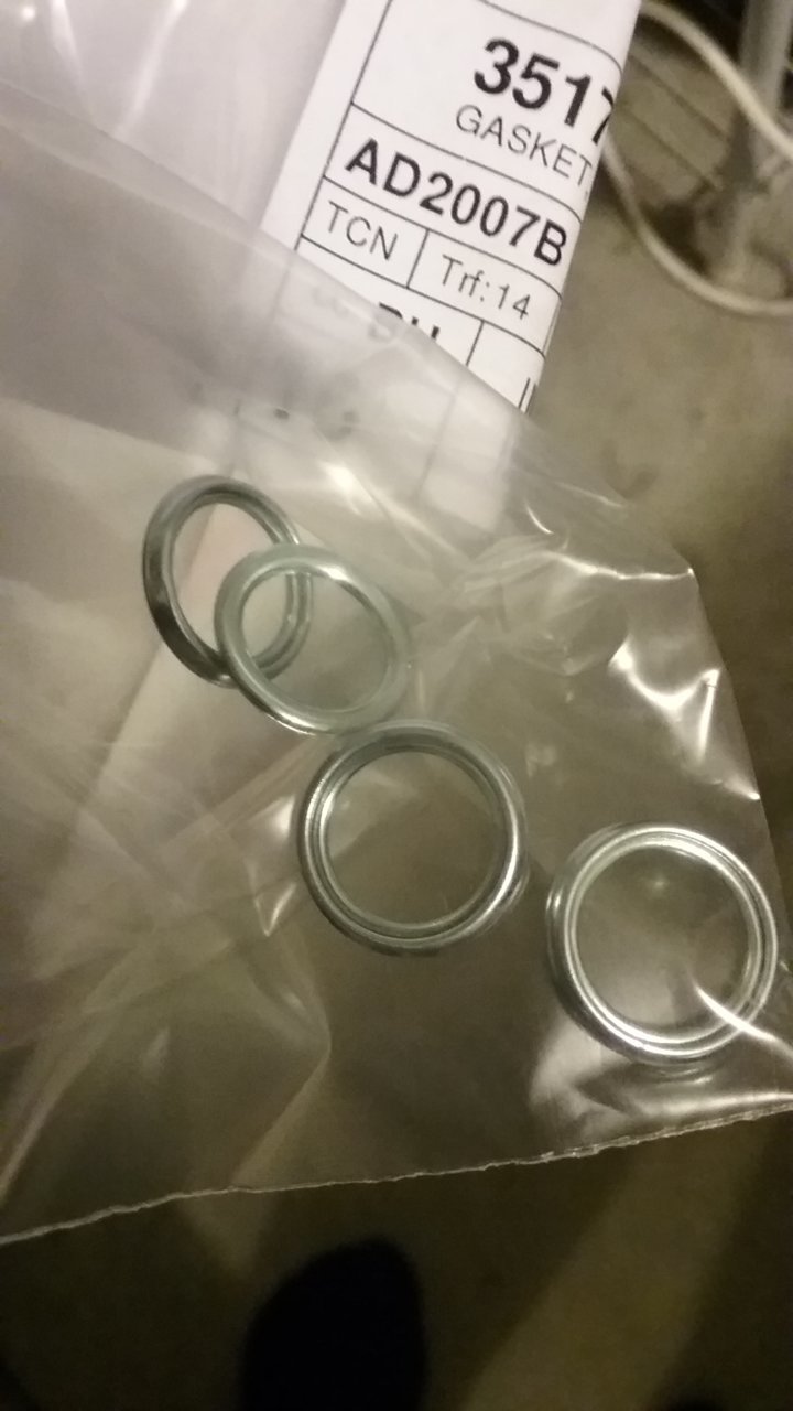

    Scored 12 quarts of WS and 4 gaskets for $95.
    Going to do a series of 4 drain and fills over the next couple of weeks

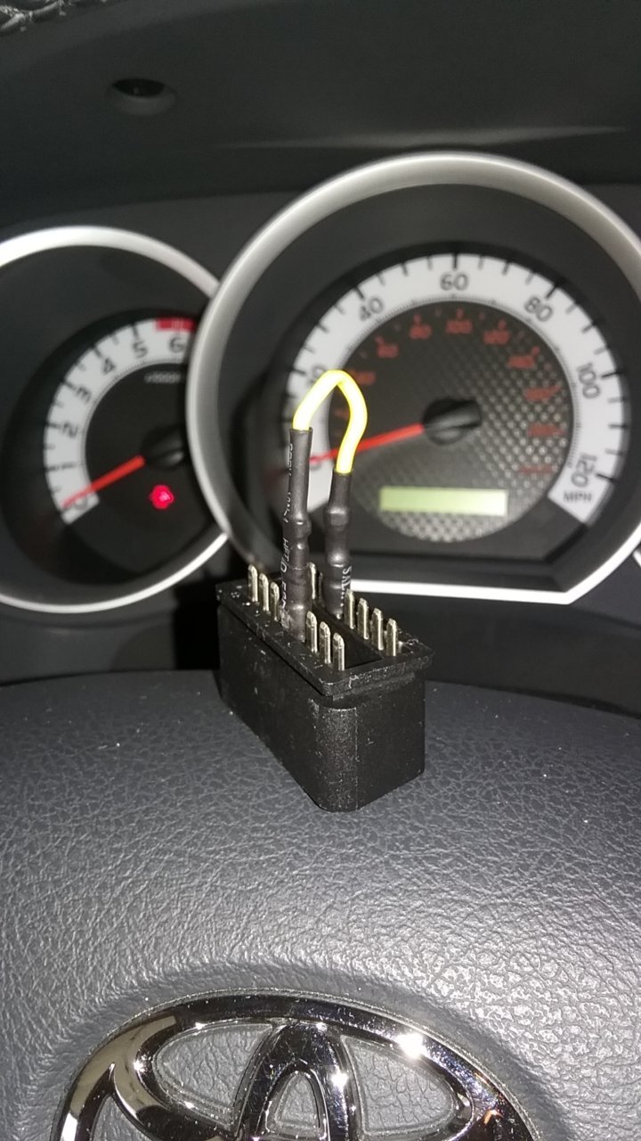

    1 down...3 more to go. Was pleased to see my factory fill looked pretty good. Had some red color to it, not very dark and didn't feel or smell funny. I'll do another one tomorrow and 2 more next weekend.
    '15 TRD Sport PR. 55k miles. 1/3 city driving, 2/3 highway driving. No towing.
    I recommend the OBDII trick. And be patient if the transmission is cold and the outside temp is too. About 29° this morning. Took a good 30 minutes of idle time to get the light.
