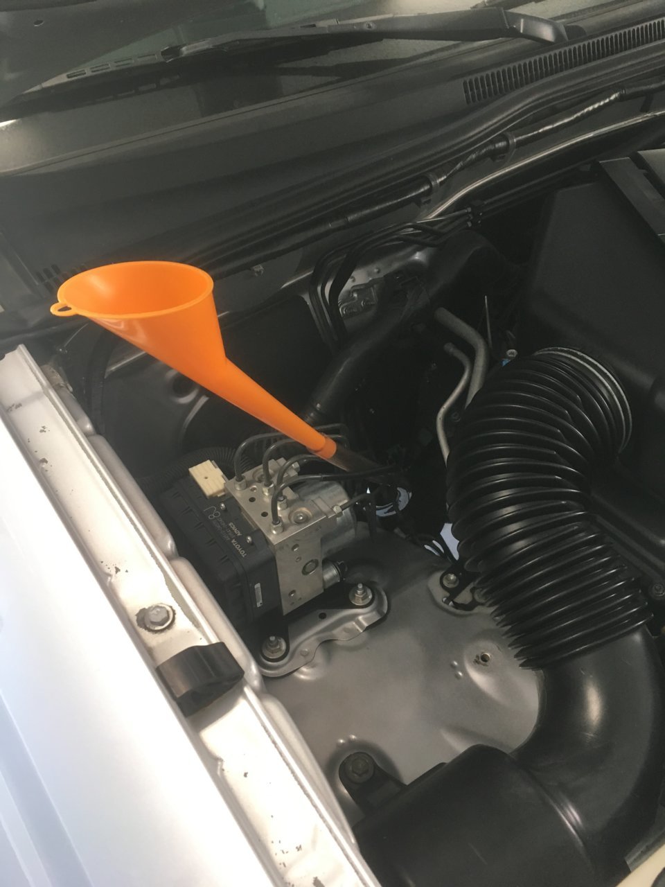

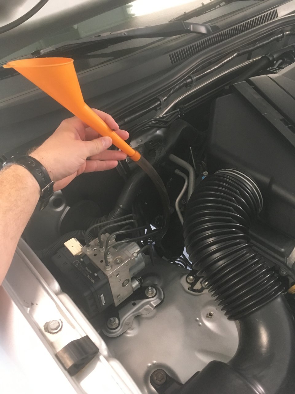

    I bought a blank on eBay for 5 bucks. It would unsnap so you could run a wire and snap it back together.

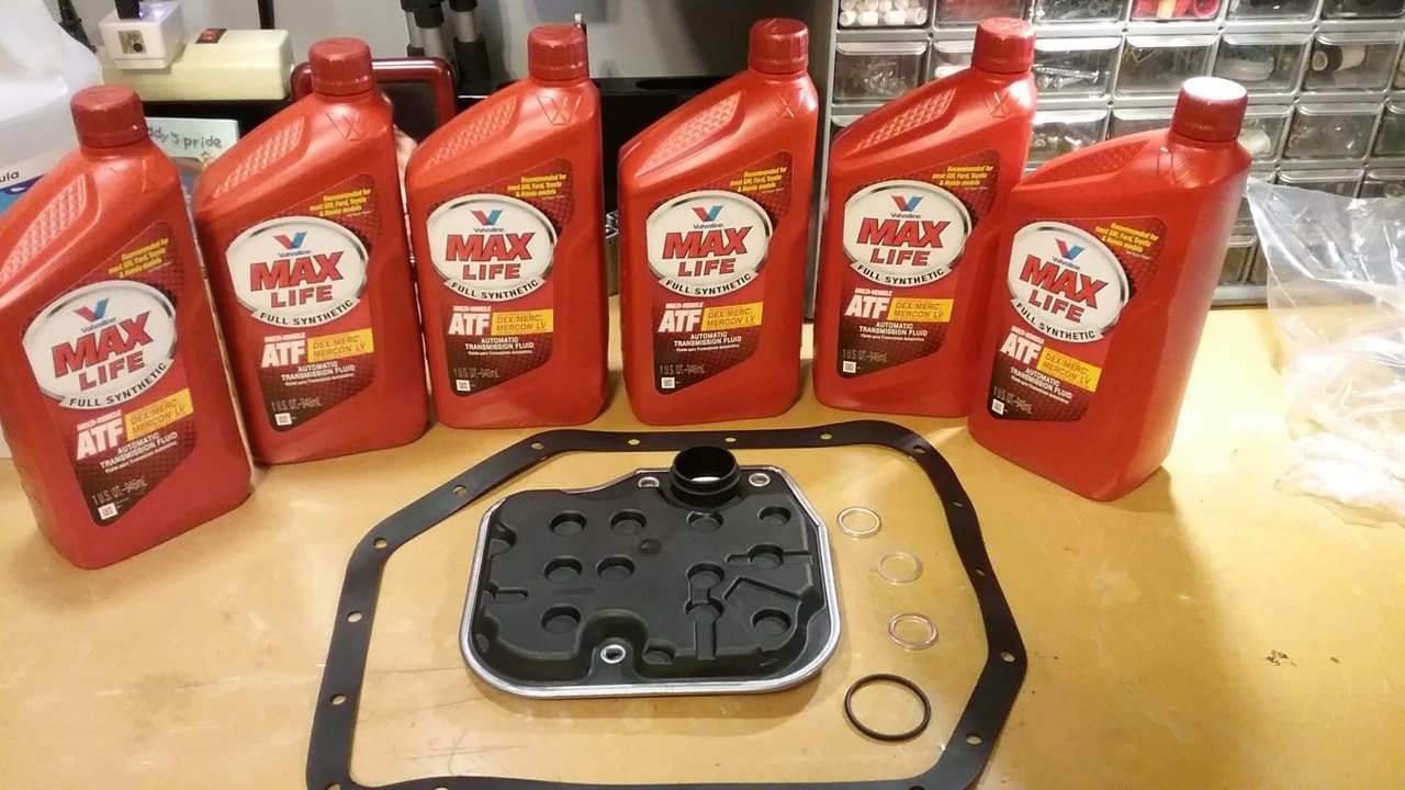

    I've had great success in several of my extended family's Toyotas using ML. As I close in on 100k miles on the Taco I plan to switch over to ML....along with a pan drop and filter change. I do a suck and fill on the power steering fluid with ML at every oil change.
    I also use it in my Daughter's old Yaris.

    I already did a pan drop, new filter and gasket and full flush now I do the regular daf

    How long have you been using the ML?

    60 - 70k I think

    We have extended family with an '03 Camry with 190k miles and an '04 Sienna with 160k miles...both running great and shifting smooth. Both have been on ML for years.
    I bought my daughter's '10 Yaris a couple of years ago with 126k on the clock. One of the 1st things I did was service the tranny with ML. Shifts flawlessly
