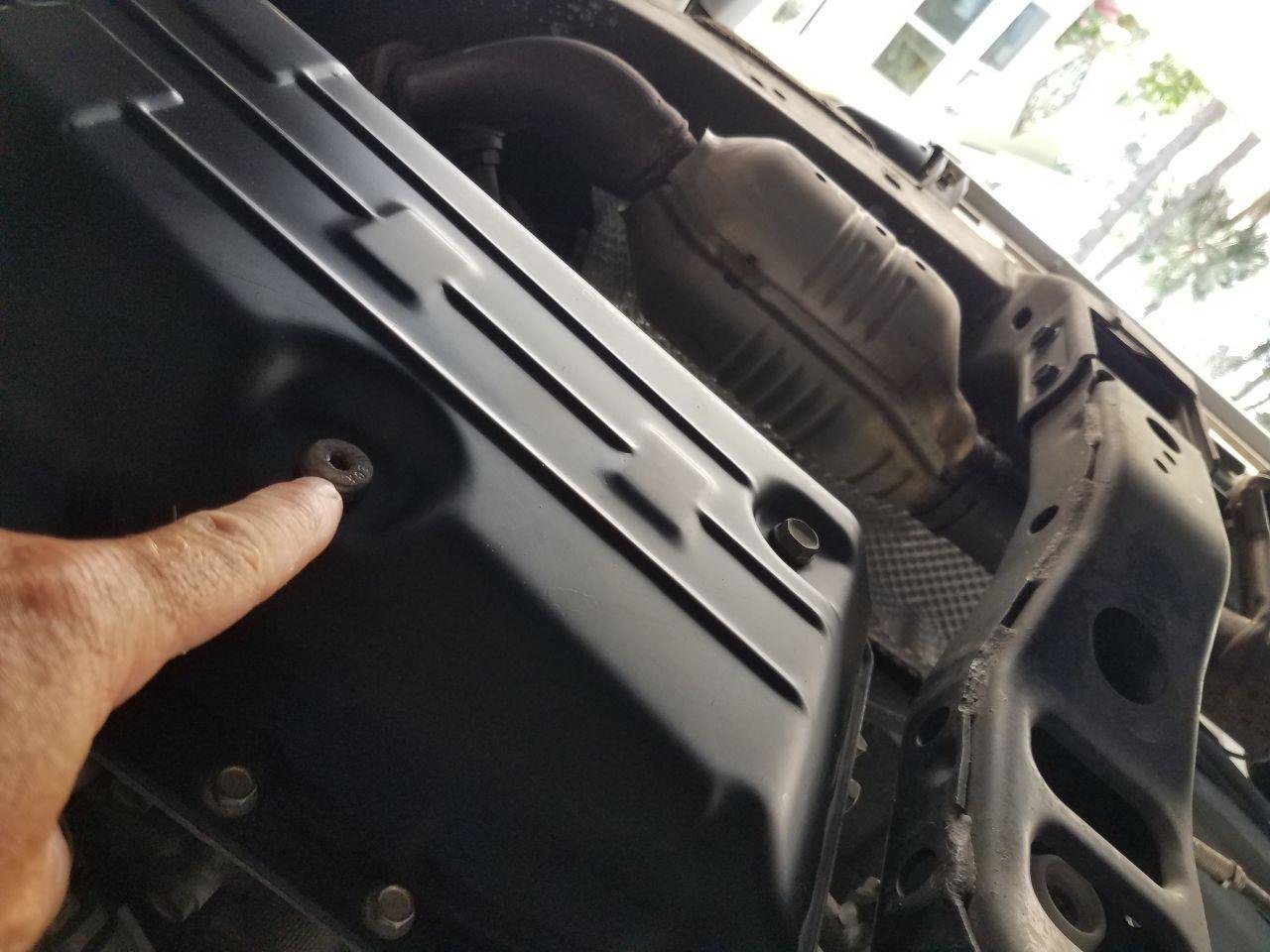

    Just so you know I am pulling the correct plug..... me pointing to the "over flow check plug"photo_2020-07-04_14-16-20.jpg

    Yes, that’s the correct plug. :thumbsup:

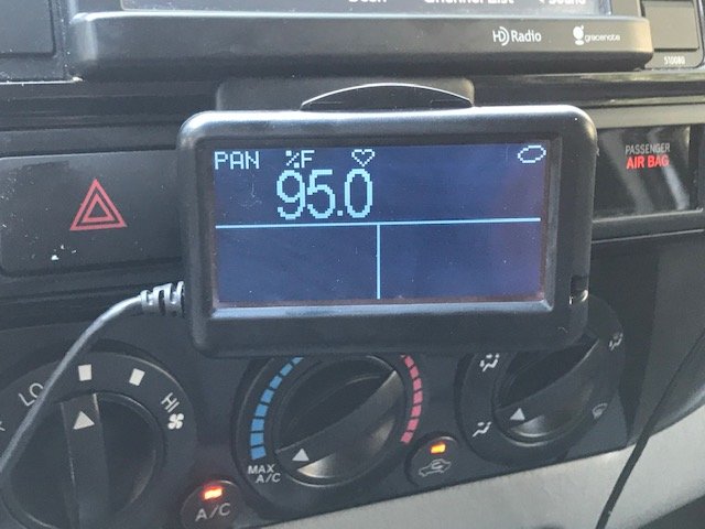

    using the jumper method is certainly one way to do it but I went the ultragauge route for determining the transmission fluid temp when adjusting the fluid level after a drain and fill.
    Haven't done any towing yet but I can tell that the max temp I have so far seen is about 165F so the factory cooler is doing a good job... I have an additional cooler installed but the oil cooler thermostat I installed wont open till 180F so its not even at play at 165F.
    Added benefit is that I can see the temp any time I want and have available all the other hundreds of gauge function this thing has.

    What was the temperature you used, as read out by the UG?
  20. Jul 28, 2020 at 12:35 AM
    #1560
    babylon5
    babylon5 Well-Known Member
    Aug 19, 2015
    #162175
    926
    David
    2015 Tacoma Double Cab TRD Sport
    115F pan temp...
    The UG can also monitor converter output temperature but the fluid level measurement temp is supposed to use pan temp.
