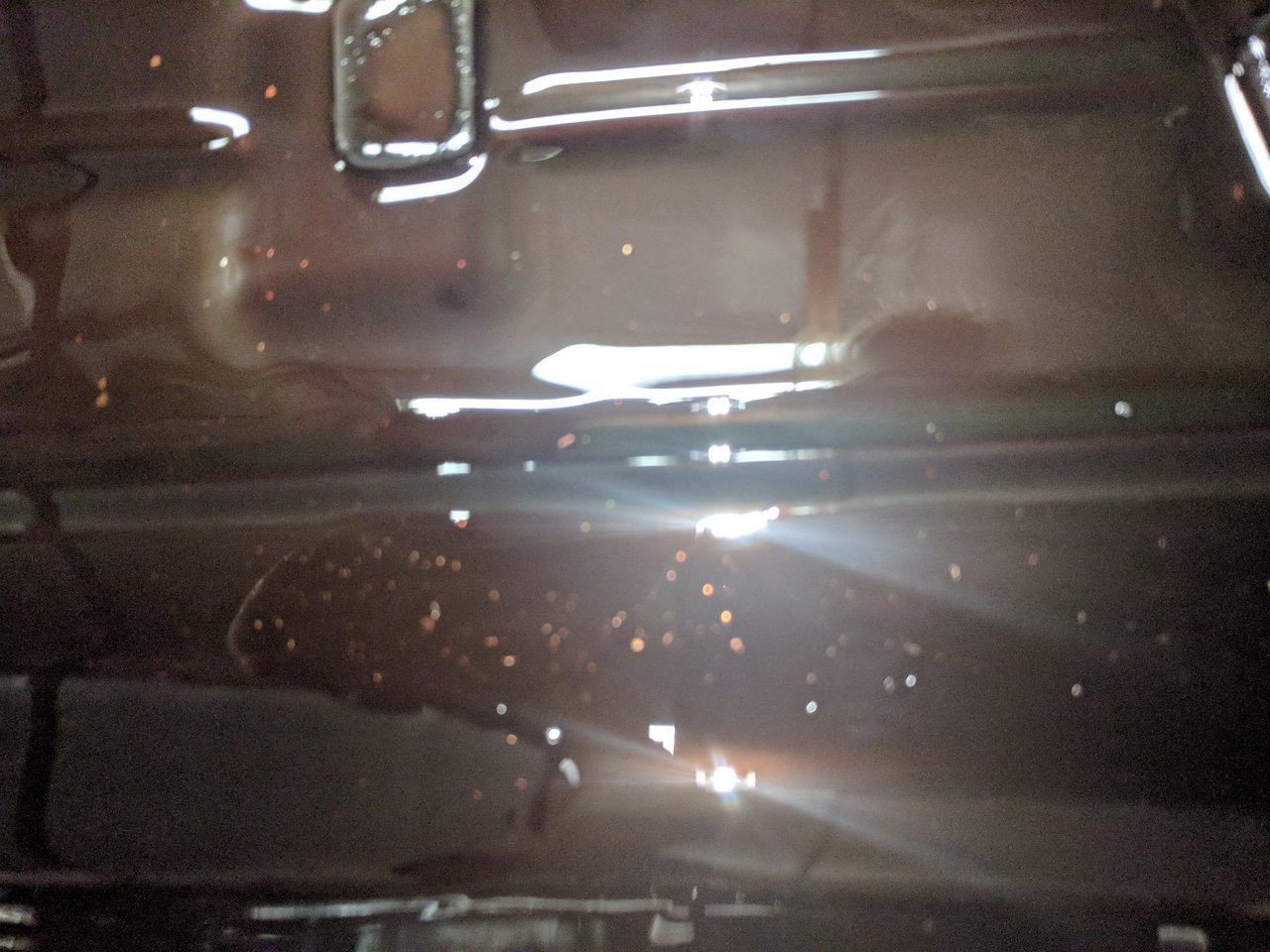

    I have been trying to convince the boys to service their transmissions this way since I joined Tacoma World back in 2011.
    If you guys scrolled through hooks write up and noticed the sludge on the magnets and sludge in some of these transmission pans , well thats the stuff you risk flushing through your valve body when you flush a transmission without removing the pan first .
    This is critical if your pan has never been off .
    Do you know what the bottom of your pan looks like ?
    Does the Tacoma World member who just flushed his transmission know what the bottom of your pan looks like because you guys have the same mileage ?
    You cant base your opinion on how to service your transmission based on what the other guy did with their truck at the same mileage . It just doesnt work that way .
    Take the pan off to be sure
    THE PICTURE ABOVE IS A PEFECT EXAMPLE OF WHY YOU SHOULD NOT FLUSH WITHOUT REMOVING YOUR PAN FIRST . DONT BE THIS GUY . THERE ARE TOO MANY GUYS AT TACOMA WORLD MAKING THIS MISTAKE .
    THE TRANSMISSION WORKS SO I AM JUST GONNA FLUSH IT !
    WHY ARE WE REMOVING THE PAN ?
    When you introduce new transmission fluid with " SUPER DETERGENTS " into a dirty pan , the detergents in the new fluid will lift that junk rite off the pan and magnets . When the junk lifts ,it goes through the hydraulic circuits acting like sand paper on your " all aluminum transmission " .Those particles on the magnets are steel and the particles dont play well with your " all aluminum valve body ".
    Those particles plug up your shift solenoids . A solenoid from Toyota is $400 bucks and your pan will have to come off to change it
    Those particles plug up the shift valves behind your solenoids . Now you have to remove the pan and drop your valve body . Thats over $1000 bucks to have perfomed at a transmission shop . Toyota dealerships dont drop valve bodies to free up stuck valves . They will just quote you for a new transmission
    Those particles block cooling passages in your internal radiator cooler, then your trans starts to overheat . Now you have to replace the radiator $$$$$$$
    Most of you wont know there is an issue until its too late because this computer controlled transmission compensates for wearing internal components .
    I dont listen to Toyota , I listen to the guys who built your transmission ...Aisn Seiki say to change your fluid every 30k.
    Take the pan off when you service these transmissions please and thanks .
    Taking the pan off involves more work than a flush ? ...Yes
    Is removing the pan the proper way to service a transmission ?
    Yes ,removing the pan is a much more thorough service and 10000000 times safer than just flushing .
    When you remove the pan , you get a baseline on the internal condition of the transmission and how long its going to last .
    You are not doing yourself any favors by flushing a transmission with a bunch of crap in the bottom of the pan . The pan , magnets and filter should always be cleaned before you flush the converter , cooling system and hydraulic circuits

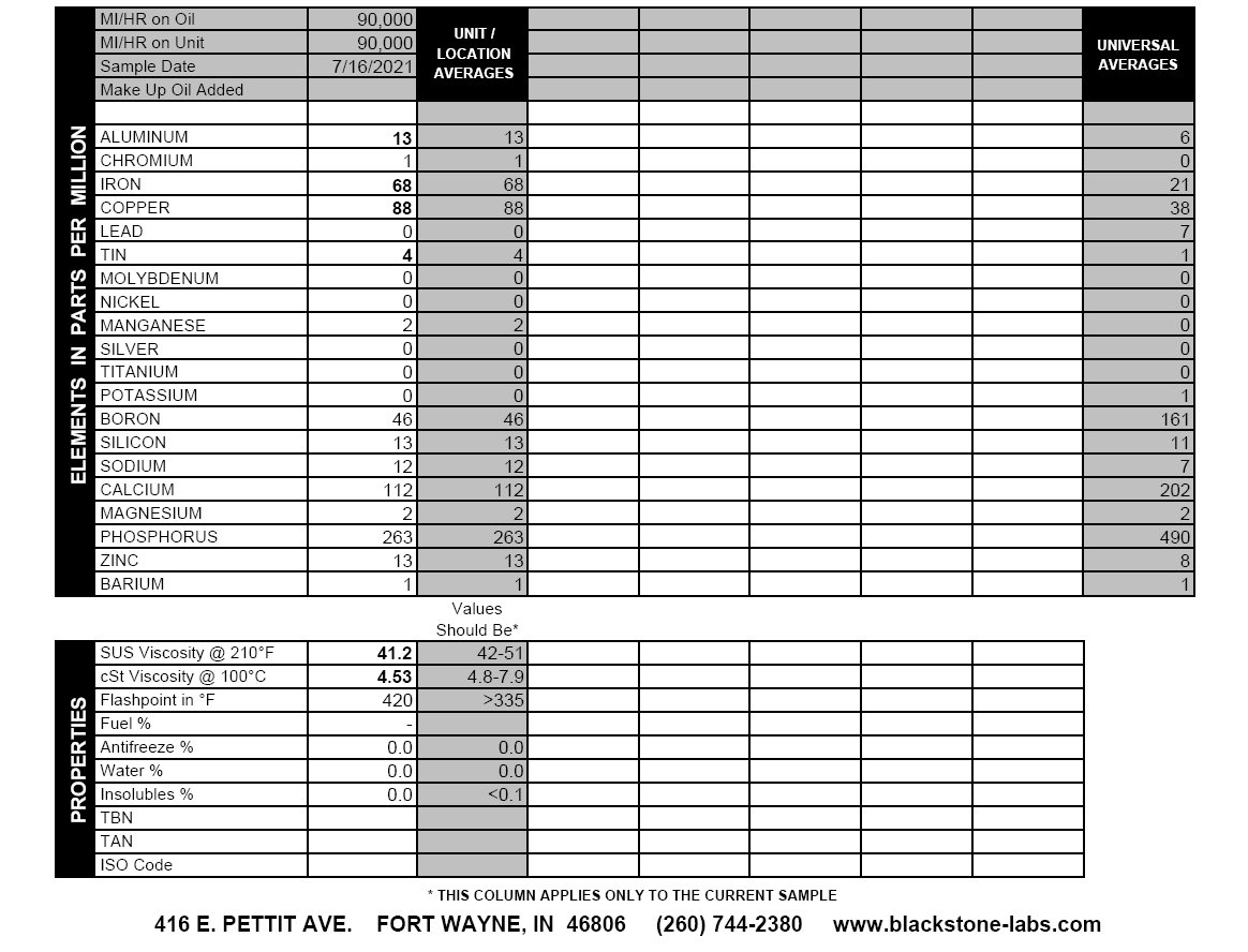

    Got my ATF analysis back from Blackstone Labs a few days ago. Figured Id share it here for what its worth. As I noted before this was my first pan flush, just over 90k on the original fluid. Had a decent amount of gunk on the magnets and a few small particles in the old filter. I wheel a decent amount, but overall Id say Im fairly 'easy' on the trans and try to drive in a manner that keeps the temps low (torque converter locked up as much as possible) when on the highway. So I feel good about doing this service at 90k. Going to do a D&F with each oil change over the next year to continue to flush the factory fluid out.

    Thanks for posting that info, interesting. What does Blckstone mean by average 21,000 mile intervals for the tranny?
    So basically you had some elevated iron, copper and zinc leftover from the initial break in. Great to hear that you changed out just when the viscosity was starting to drop.

    It might be the Aisin specified change interval, although that seems quite low. I would expect 30k min to match Toyota’s recommendation

    Yeah pretty much along the lines of what I was thinking. Maybe it’s a number that comes from a database pulled directly from manufacturer recommendations, regardless of what vehicle they’re installed on.

    Was actually wondering the same thing myself. Seems like a very low average, even for the regulars here on TW :D
    I just sent them an email out of curiosity.
    Dont think Toyota has a recommended interval on these, since they say its a 'lifetime' fluid. They do reference changing the gear oil in a manual trans every 30k if you've been towing.

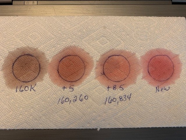

    Just did my 3rd drain & fill after completing the drop/drain/strainer a few weeks ago! Wanted to share the progression. Transmission is performing great! Many thanks to the OP and all who have contributed to this awesome thread!
