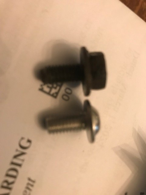

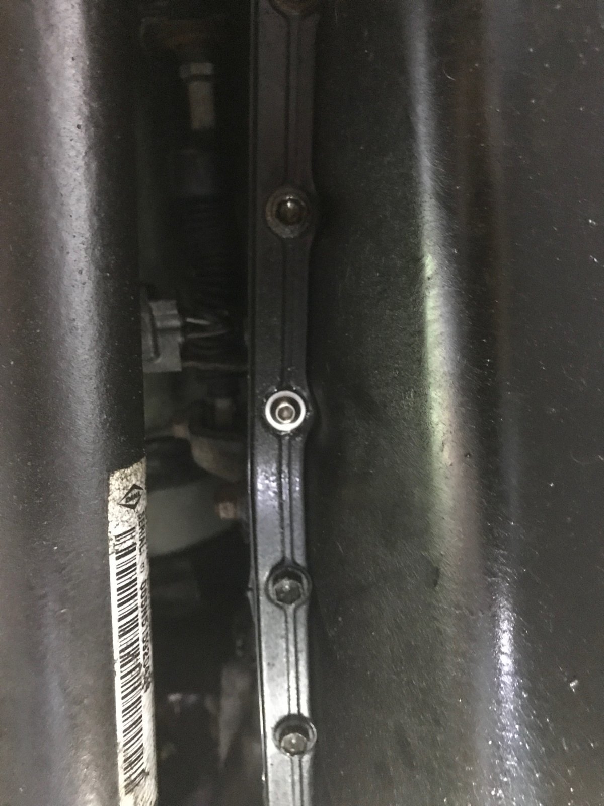

    Just doing the pan drop and filter change. Am replacing the corrosion prone washer head bolts with the stainless one piece washer head allen ones. Not worried about the stainless/aluminum issue since no salt water can get in there to act as an electrolyte. No corrosion on the threads of the original steel bolts either.
    These are exactly the same thread length and washer size.
    This was just a test fit after pulling one original bolt to measure the length of the threaded portion and the size of original washer. If your interested I can look up the Amazon order for this part. And after this pan drop and filter change I will never be doing this again so yes its overkill. But its stainless... Got to have :thumbsup:
    And while down there will doing the u-joint greasing.
    this is old vs new bolt comparison
    https://www.amazon.ca/gp/product/B098D95M8T?ie=UTF8&th=1
    Heck, the new ones are much smoother and aerodynamic. Probably increase gas mileage :rofl:

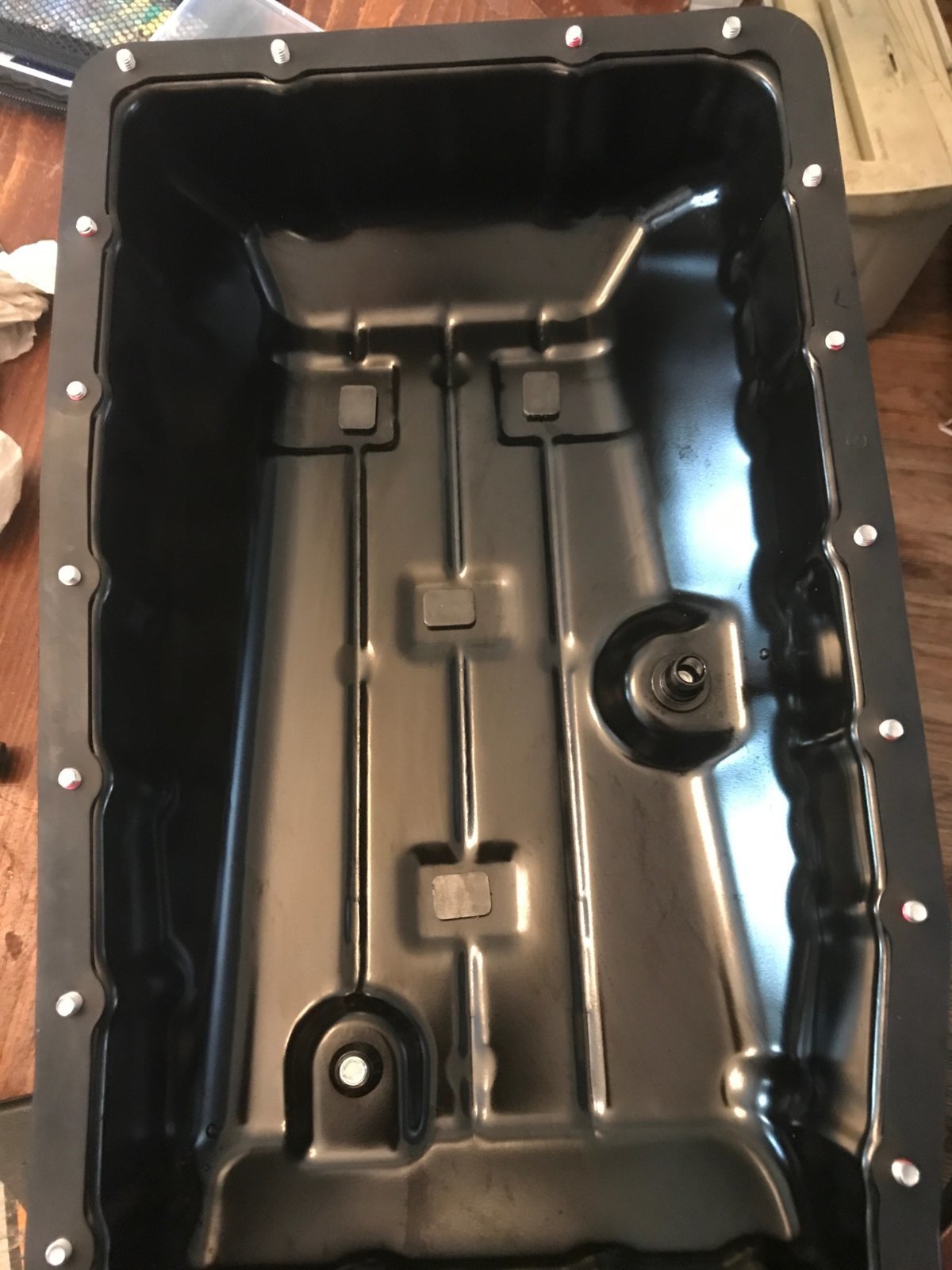

    Measured original Toyota pan gasket. 1.92 mm. The Beck/Arney was 1.63 so not really concerned there. Original may have even swelled a bit over time. Magnets where only slightly coated.
    One thing great about this gasket is that holes are a teeny bit smaller than the bolts so you can put all the bolts in ahead of time and don't have to fiddle with trying to line up the gasket and holes as you try to install them.
    Installed new drain plug and overflow tube gaskets. And since I would not need to open the drain plug again as part of this I torqued it to 15 ft/lbs while it was on my table.. Saw that the steel gasket compressed and and fine with that setting.

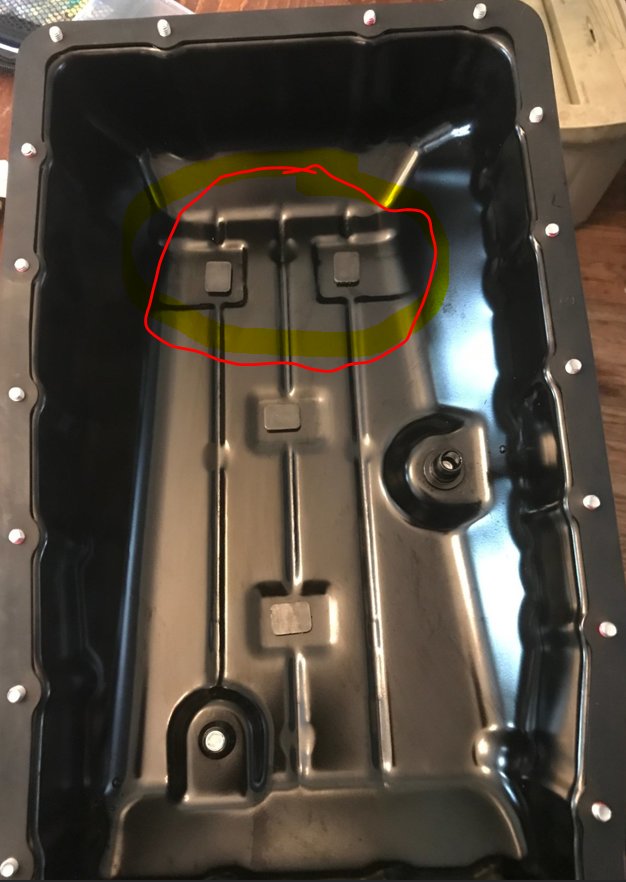

    Looking at original filter (screen) (visibly quite clean) and pan and magnets this is probably one of the only times I feel that maybe this a nice to have rather than needed. But its done and that the last time for me :thumbsup:

    Jeff
    Central Florida
    13 DCLB TRD SP PR OTT
    "If it ain't a longbed it ain't shit! :)
    C'Mon man, get those magnets in the correct orientation!! :D

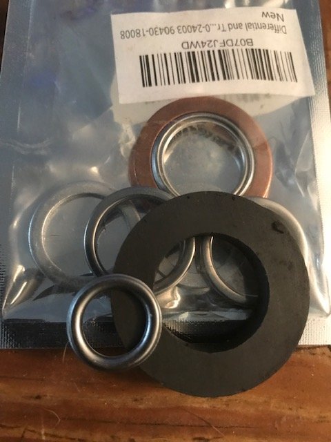

    Can anyone think of mechanical or metallurgical reasons for the different types of crush washers.
    On the Tacoma where its steel bolt on steel surface I have aluminum washer (oil pan drain plug), Copper washer on front diff drain plug, Steel crush washer on rear diff drain plug? Steel crush washers on both transmission drain and overflow.
    All are exposed to oil. All are exposed to the elements. All can see about the same temp range. Cant be to concerns about dissimilar metals corrosion since they are all different exposed to steel in all cases

    What you think are steel are likely aluminum without looking it up and checking. Both aluminum and copper are soft allowing for them to perform their job in conforming and sealing. Copper is softer so its use in certain applications likely has to do with the torque value of that plug.
    Edit: the transmission drain and overflow plug crush washers are definitely aluminum.
    Edit#2 this is incorrect and several sellers are incorrectly identifying the material as aluminum. And it makes no fucking difference to…anything.

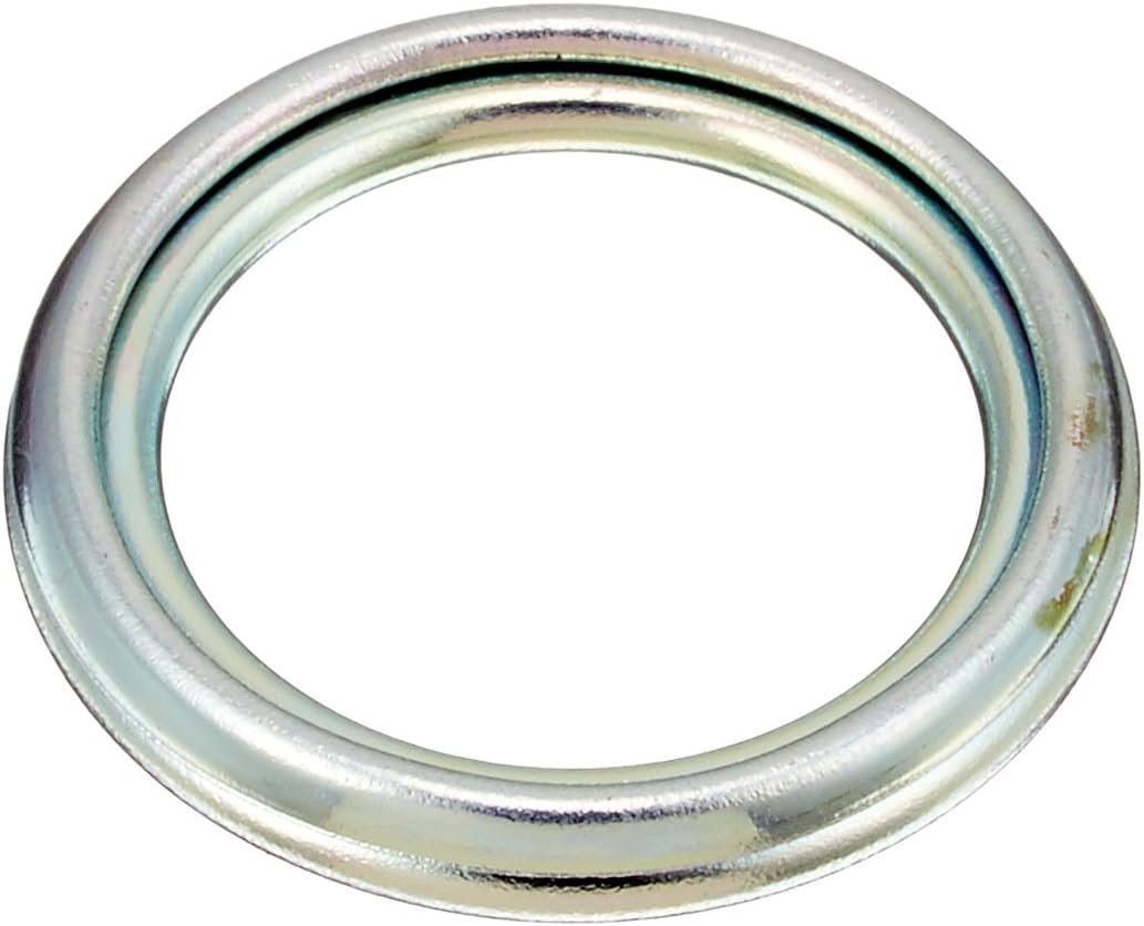

    The steel ARE steel. The one on top of magnet is steel crush for transmission and the two large steel ones under the magnet is sticking to are for the differential. They are not solid steel. Sort of tubular so they can crush and flatten. If you looks at the one sitting inside the copper one you can see the design better. And on my 2nd gen the transmission are not aluminum, they are steel also. The only aluminum one is for transfer case drain plug.
    I just replaced the original ones when i did the filter change. They were flat and rusted around the edges and steel and stuck to magnet.
    The one sticking to the top of the magnet is the transmission crush washer. Toyota part # 35178-30010
    Aluminum ones are solid , not folded like this. Like ones used for transfer case and engine oil pan.
    https://www.winzer.com/product/801-0121
    Steel Foldover Gasket Drain Plug Washer Toyota - 35178-30010
    M12 Steel
    Foldover Gasket
    Toyota
    OEM #35178-30010

    Likely an aluminum alloy then. I can’t find the Toyota site where I looked up the material but some other sites call it aluminum alloy. Doesn’t really matter, the answer to your question is different materials are likely used for different levels of softness.

    I just replaced the original ones when i did the filter change. They were paper thin flat and rusted around the edges and steel and stuck to magnet. I know because I had them on the workbench and they stuck to the pan magnets i had removed to clean out the transmission pan.
    Aluminum alloys don't rust and stick to a magnet. And new ones where from Toyota and also stick to a magnet. The ones for the rear diff are exactly the same design (just larger) and also folder steel.
