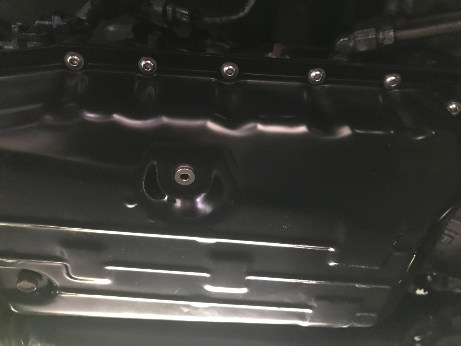

    After a weeks worth of driving I did a quick crawl under to make sure everything was leak free...
    Here is a pic of the finished job with the stainless button head pan bolts and the stainless over flow plug.
    Will replace the drain plug at the next drain and fill since I received the stainless versions after I had completed the fill and fluid level check. With the fluid still cool I was able to replace the overflow plug with the engine running and didn't lose any. The old overflow plug was rusting quite badly.

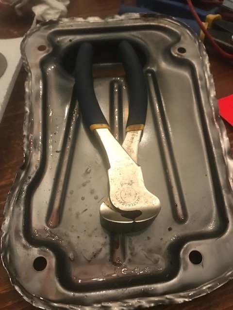

    For those that have taken the opportunity to open/inspect the old filter, how did you get it apart? Just pried it apart at the folded seams or maybe tin snips? Don't want to grind it of course since this will just introduce more metal particles and make it impossible to determine which are which.

    I’ve always replaced mine with an aftermarket kit mostly because it includes the rubber pan gasket. I only visually look at the screen through the port holes on the filter and never take it apart. If you’re going to reuse it or buy a new one, I’d say just visually look at the condition of the screen thru the filter holes without pulling it apart.

    No disagreement there. In my case though I have the time and just want to have a good look since its the first filter and would be interesting to see what it caught from day 1 up to now.
    That's why my question was "how do you" rather that "should I"

    Yes, and bottom panel is sort of folded/crimped along edges to top panel. Think of the metal on the bottom of the doors. From the looks of it I will I see if I can get a screwdriver and pry apart that seam all the way around. Metal looks to thick to use tin snips

    Had the time so decided to dissect the OEM filter. Came apart with maybe 5 minutes effort. Its just a folded metal seam you can fold back and separate the parts.
    No visible large chunks in the filter screen itself but holding it up to the light you can see a definite distribution of metal particles as well as some black material that I couldn't identify that was not iron (non magnetic).. Seeing that the screen is supposedly between 50-100 micron i am glad it did its job. But also glad I have the magnefine in cooler loop as well since I certainly do want to catch the iron particles smaller than 50 micron (spec says the magnet will catch down to 5 microns).
