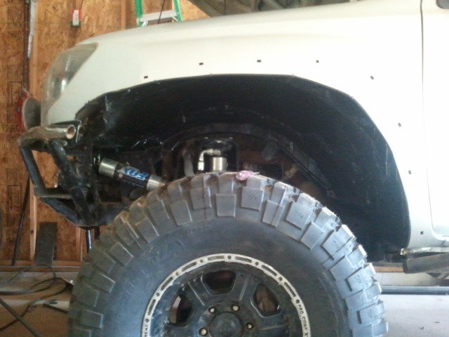

    Lifting doesn't do anything to fit tires. (minus body lift :rolleyes: ) just cut, it will be cleaner and way better in the long run.
    37's on LT
    ABSOLUTELY ZERO RUBBING.

    Icon/All Pro.....chopped for 35's
    Damn, 37's???? Who's build is that? That is as clean as I've seen. My next set of tires will be 35's and have already pounded the pinch weld and chopped the cab mount to fit my 33's. I'd like to clean it all up like the above and get some 2" flare fiberglass.
    The rear will prob be an issue?
