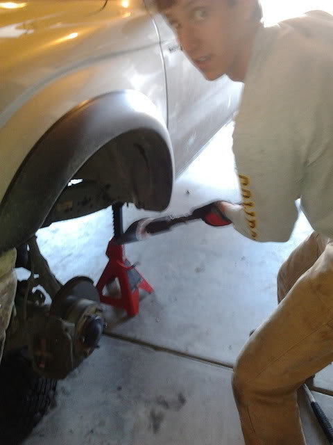

    bump for pictures of cutting.

  8. Jul 17, 2012 at 7:28 PM

    2nd gen very different I hear. looks like u just cut all the plastic?
