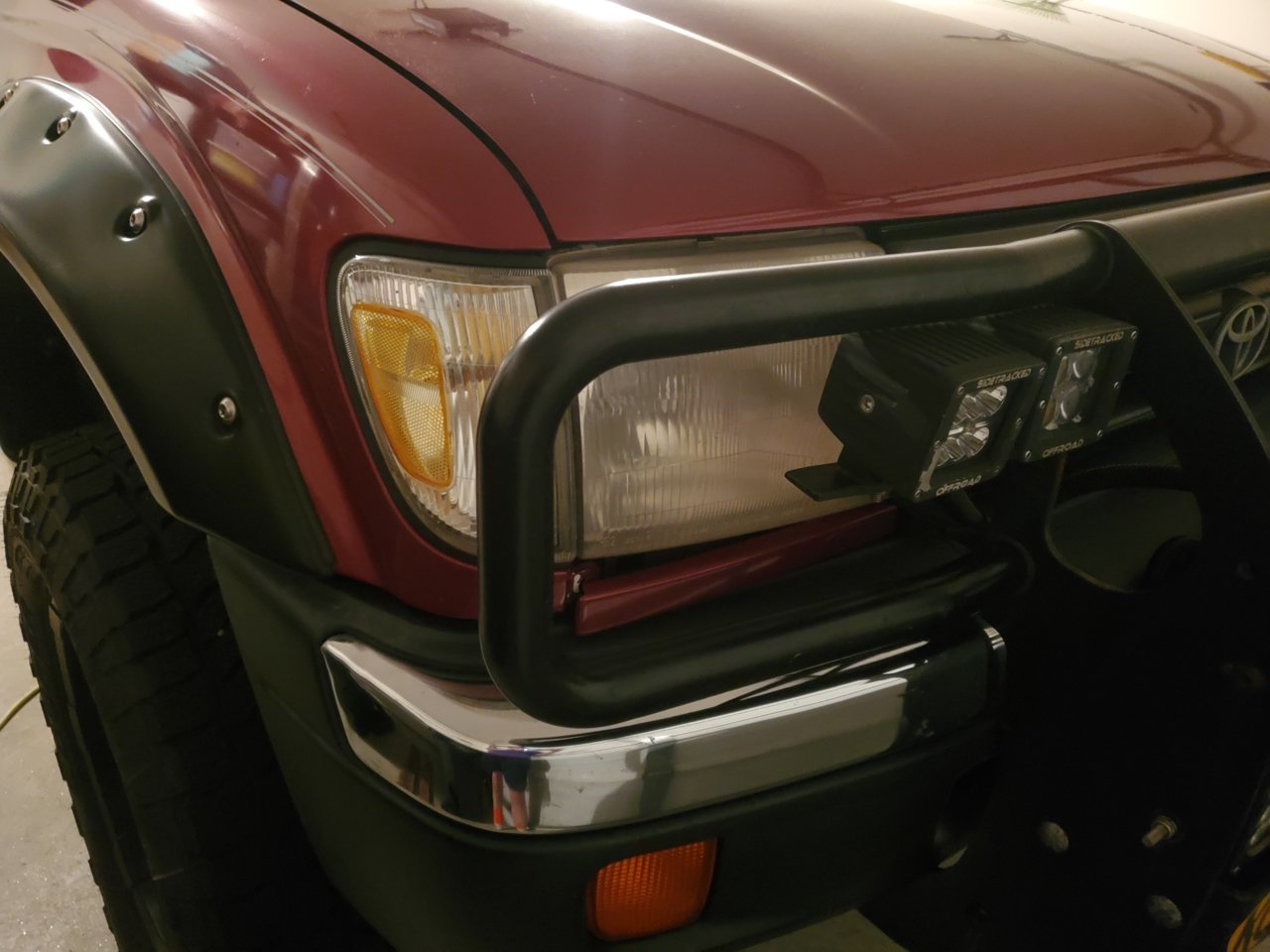

    So this piece keeps popping out after a few days of driving. Does anybody else have the same problem and how did you fix it? I dont want to use an adhesive if possible. But if that's the only way I get it. This is a 2000 extended cab.

    Had the same problem, manipulated the metal tabs out a bit and they seem to hold well. I commute on dirt roads with washouts so it has not been an issue.

    That filler panel has four clips on the backside that interlock with tabs on the grille. If they're bent wrong (easy to do) or not aligned properly (also easy) the filler will be loose. Once you've got it in, it's really quite tight.
