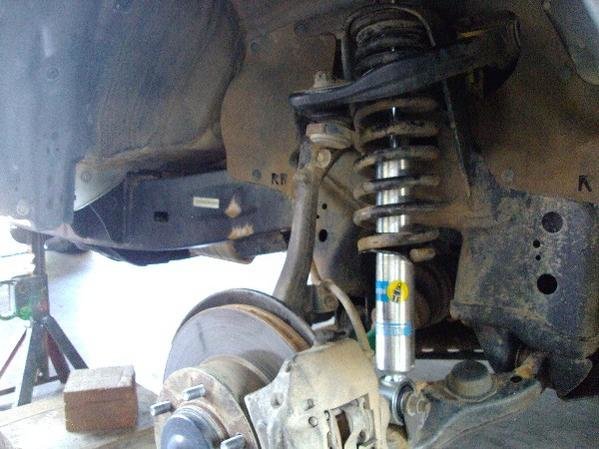

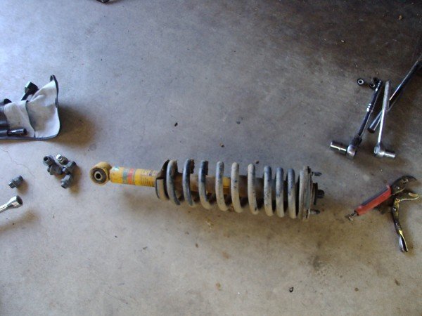

    Chris has got it laid out for you guys in a simple , straight forward, procedure & if any of you have the mech. aptitude & want to do it yourselves if you go to autozone they might just loan you the
    spring compressor for free with a $50 deposit like they do here in San Diego, I dunno, worth checking into......:cool:
    couple pics from my 1st gen. procedure (bsically the same as 2nd gen in regards to R&R/safety issues) pic with the center nut thats not to be removed until spring is correctly compressed (it holds the "pre load").....good luck:D
