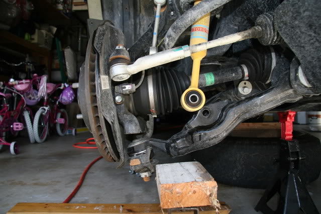

    I'm missing something and need help visualizing this. What is the point of disconnecting the upper ball joint from the spindle when you're just going wire or zip-tie the spindle up? Is the idea here to give the spindle enough droop but just without putting excess tension on the brake lines? Serious question - just want to make sure I've got the concept right. I've never torn this stuff apart. Just used the jack method on the UCAs on my '01 Taco.
    Also, dropping the LCA as done in the previously posted video seems to be pretty simple and less invasive (ie: not messing directly with ball joints and studs). Chris mentioned earlier in the thread this method works when the truck is up on a lift, but why won't it work while the truck's up on jack stands?

    I just changed my springs and shocks by dropping the LCA. I was on jack stands and it worked like a charm. I used a pry bar between the spring and UCA to lower the UCA to mate up with the LCA. I would not want to do it any other way.

    You have to hold the top of the spindle stable, other wise if it flops over, it can break the ABS sensor. Disonnecting the LCA is fine, but when doing so with jackstands, you dont have much clearance to reconnect it.....Just my opinion. Either way worksd fine.

    As a note, like others, I had to disconnect the tie rod ends to get the coilover assembly out. It started out okay beforehand, but the upper half of the coilover assembly just started getting wedged between the tie rod and CV boot on the way out.

    All you have to do is loosen the nut on the top of the UCA and give the spindle a good whack with a BFH right on the side it will pop right out every time. Don't hit the top you just risk messing up the threads.

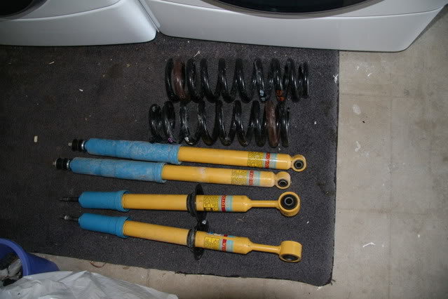

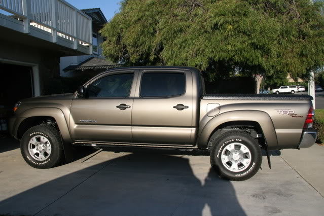

    I was thinking the same thing! I was going to install the 5100's myself then take it in for a free realignment along with the TSB. I thought of just doing it and not saying anything but I mentioned it to the service writer and he said no bueno on getting the alignment with 5100's and Eibach spring (well not for free as part of TSB). So I just let them do the TSB in the rear on Tuesday. Today I did the rest (4 - 5100's with Eibach's up front at the 0 setting). Then rushed it over to Firestone for a Lifetime Alignment. Now it sits nice and level ( I have a tonneau + other stuff in the bed for about 170lbs). BTW I did it per the video on post #333 a couple of pages back. A couple of notes though. First make sure you jack it up so the tires are 4-5 in off the ground so you have plenty of room to swing the LCA down and out of the way - and to do that you must loosen the bolts that attach the LCA to the frame. Then remove the two bolts that attach the LCA to the hub assy or spindle (not sure on the terms). Thats all shown on the video. Then the strut will feed right out. Helps a lot to have an impact wrench as shown. Another thing mentioned by someone else doing it this way is when reinstalling the 5100 the shock is longer and you must use the jack to push the LCA back up to get the two lower bolts started. When doing this it actually starts to raise the truck until you get enough weight on it to close the gap enough to get the bolts started. You must have jackstands as far out to the side of the truck as possible to get more leverage allowing the shock to compress. Hard to explain - but other than that its pretty straight forward. The only thing else I noticed in using the original top plate hardware on the 5100's when its all assembled and the truck is down on the tires I can actually turn the washer and bushing thats below the nut that holds the top plate down on the strut!! It's like it needs a thicker rubber bushing on top because the nut is cranked down as far as it will go?? But I dont thing this will cause and issues, there's really no gap it's just not sandwiched down on top when the spring is compressed by the weight of the truck? Anyone else notice that? if I'm making any sense. :confused: EDIT - I think this is because I left out the boots? They would be taking some of the space on the top.
    stock
    with TSB only
    5100's with Eibach / Toytec spring's up fron at 0 setting
    other pics --
    new stuff
    Note - I left out the Boots accidently :confused: I'm not going to worry about it for a while :(
    Hmmm - these shocks have only 4000 mi on them and honestly - the rears dampen about the same as the 5100's IMO. just the 5100's are much beefier and could handle more abuse. I probably would've been ok just keeping the stock bils cause I wont be abusing it much. That said you could probably get away with putting the Eibach spring on the stock Bil front too and add a small top spacer if you want more. (If you want to do this on a tight budget that is) I would definetly get the Eibach spring though - I like the ride much better. The stock Off Road spring is only better on the tiny little ripples on the road because of the progressive nature but if you compress it then it gets worse, whereas the Eibach gives a nice smooth, linear compression. I can tell off road its going to be Tits!
    One more shot of the stance now
    Wheels and Tires next :cool:
