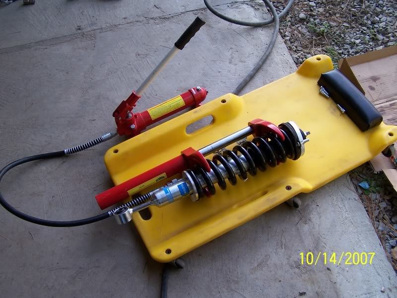

    I had some similar troubles with Autozone. I didn't have a compressor so I was gonna let them do it, until I saw how they were going about it. Had to shut that down. Went get my own spring compressor.

    Much easier to remove 1 nut, than to remove the whole UCA. Why go thru extra steps if its not needed.

    We put the OME 885's and the 10mm lift enhancer on Packerfan's truck. He got just over 3.75" of lift.

    I did not remove any ball joints or control arms. The lower ball joint separates in half; it is held by two bolts. The lower conrol arm bushings did have enough tension to keep the LCA in place, but, having dealt with ball joints on other cars, I found it a lot easier to deal with the LCA than with ball joints.
    I swapped the coil springs. I measured the ride height before the install and noticed the driver-side was about .25" lower than the passenger side. Wheeler's Off-Road made the suggestion and it worked!

    im a big fan of doing everything myself, so during a coilover install for my WRX, I found a set of cheap spring compressors from sears for 55 bucks that do the trick just fine. not a bad investment for the price.

    Thats another way of doing it. I prefer to just get the Upper arm out of the way. Give a little more room to work in there.
    The Tacoma Springs have been known to break and bend the shit out of those types of spring compressors.

    Hmmm, that coil compressor is not a good one to use? What kind would you suggest? Remember I got the 886's from him. THX
