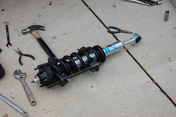

    Put my 5100's on today, while doing research I saw a lot of people were apprehensive about using the auto parts store rental strut compressors... these actually worked out well. Probably took me about 5 minutes to compress each spring and less than that to decompress. Felt completely confident the whole time.

    Congrats on using the manual compressors. The issues that have been raised, and rightfully so:
    1) You don't know where the compressor has been, how well (or not) it has been taken care off, and how many times it has been dropped. If one of them breaks the spring will recoil and can seriously insure you you. I've seen all kinds of metal 'break' during normal use with no warning at all.
    2) If you don't have the right power tools to compress both, it's a PITA if you can even get it done at all, and
    3) these types of compressors might not fit your coils to begin with. They didn't fit inside my compressed Toytecs, making them useless.
    Issue 1) and 2) don't mean you can't use them. They just mean using them isn't the smartest thing you can do. We're not talking about springs from a Corolla or Camry here. I'll end it with a corny note: Just because you can, doesn't mean you should.

    It doesnt matter how many times you have done this, those compressors suck, and can be dangerous. A compressed spring from a Tacoma has a shit load of stored energy. Not too long ago, I found myself VERY lucky, as one that was on a 5100 shock, blew off the spring seat. Fortunately, the only damage was a cracked wrist, and a broken thumb. 6 weeks or so in a cast. It could have been worse.

    I just don't trust anything fully but a wall-mounted/free standing compressor. These truck coils are some pretty heavy rates. They can kill you if things go wrong in the right way.
    To the fella above, no need to break out any manliness comments regarding the use of spring compressors (really?); I feel plenty confident about where my truck is and the work I do on it, thanks.

    This is why most of us DIY. That spring compressor shown (post #386) is the same one I have see post #362. I believe its a Craftsman and has worked flawlessly for me on several vehicles including my Tacoma. They're beefy and when used properly and lubed up each use should last indefinitely without failure. A friend use one to install a leveling kit on his F350 Superduty. Those springs make the Tacoma springs look whimpy. If you take the screw all the way out you can then fit them into springs that are compressed a lot then screw them together and complete the job. They worked on every application so far. To each his own.

    Cool for you, and my comment was out of line for sure. You can see I retracted it before you got here. Given some common sense and a bit of arm strength, I simply see no NEED to use anything more heavy duty on stock springs. Preference of each individual will dictate action, as always, and anyone can do anything they like with their trucks. However, I don't like to spend money on anything I can possibly do myself. I had some doubts about the tool before I did the work (mostly from other observations in this thread), but I wanted to put it out there that the concerns should not necessarily dissuade anyone from giving it a good college try.
    Bottom line is that for a person with ability and caution, they are a great asset help to make the 5100/stock coil combo even cheaper to set up than the great deal it already is.
