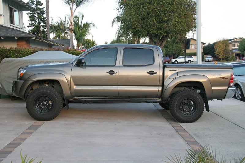

  16. Mar 18, 2013 at 8:10 AM
    #436
    HB Taco
    HB Taco Well-Known Member
    Apr 10, 2011
    #54683
    1,240
    Curt
    Huntington Beach, CA
    2019 F150 FX4 S Crew 3.5 TT
    I swung the LCA down. just loosen the cam bolts a little and the cams wont move. The alignment is going to be way out of whack after the lift anyway. Put the clip at the .85 setting since you lifted the rear. I have about 2" lift in the rear (via TSB + Deaver aal's) so I still have a little rake but I like the way it sits now. Besides I carry stuff in the bed all the time. It's sooo much better now that I can carry a load in the bed and not bottom out all the time and I removed the overload spring. Curious to see if you get the dreaded front diff vibration as soon as you lift the front. Also the take off shutter from the rear? Neither are a big deal though. Fun stuff! Here's how it sits now.
    11TTacoma likes this.

  18. Mar 18, 2013 at 8:50 PM
    #438
    Monster1
    Monster1 Well-Known Member
    Sep 7, 2012
    #86405
    59
    San Antonio, Texas
    2012 Texas Edition DC Tacoma 4WD
    Weathertech digitals front and rear, TRD exhaust, Coverking dash mat, Oem Tacoma bedmat, Better Built tool box, bed extender, Toytec 1 1/2" AAL, Bilsteins front and rears, fronts set at .85, K&N filter, aluminum skid plate, EGR vent shades, locking tailgate handle, TRD emblems, Cal Trend seat covers front and back.
    I like the stance, I wouldn't mind getting that stance, with what I have so far would I get a similar stance with mine? 1 1/2" AAL, 5100's all around with the fronts set at .85 with toytec/eibachs. Thanks
  19. Mar 18, 2013 at 10:16 PM
    #439
    Sport2012
    Sport2012 Thin Blue Line
    Jan 17, 2012
    #70872
    63
    NJ
    12 TRD Sport DCSB 4x4
    Tint, EGR In Channel visors, Access-Lorado tonneau, Tacoma bed mat, Plasti Dip Badges, Tailgate mod, Fog light anytime mod, Toytec (TTHA-CK) 3" lift kit w/height adjustable coilovers, 5100's w/Eibach coils, TSB AAL, LR UCA's, CB drop kit, Diff drop kit, XD spy's on 285/70/17 Duratrac's
    Yes, you will probably get a stance very similar to that pic..I have that same set up, 5100's @ .85 w/620 Eibachs and 1 1/2" AAL, and its just about level, to the eye. Maybe 1/2" or so higher in the rear when you measure it.
  20. Mar 19, 2013 at 8:06 AM
    #440
    HB Taco
    Apr 10, 2011
    #54683
    1,240
    Curt
    Yes it should be very similiar, if anything just slightly lower in the rear which should be perfect. Post pics when your done.
