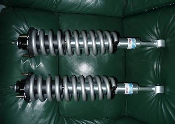

    Matt,
    I recently installed 5100 and Eibachs. I wanted to make life simple, so I found all the parts needed to assemble my struts, then just swapped them when the time came.
    I bought the isolators off ebay. I couldn't find anything for 2nd gen, and the ones I found are listed for first gen. I bought one as a test and it fit perfectly ... $11.
    The top plate is a Monroe unit from RockAuto ... $18.
