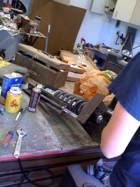

    I recomend a wall mounted large spring compressor. Or the one pictured above.
    Good for springs up to 10". The Tacoma springs are 14" and many after market springs are 16".

    Just tore mine apart yesterday...
    Couple things I would recomend...
    a pry bar or big flat head screwdriver, some reason my coil overs didn't want to get out of the lower mount....
    also when you go to re-attach the upper ball joint if you jack up right under the lower control arm it will be a bunch easier than putting all your weight onto it to try to get everything lined up....

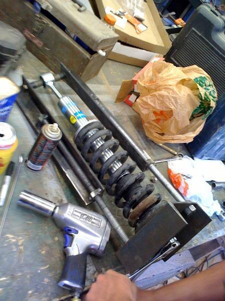

    This is what is meant by a spring compressor, DO NOT use one of the wimpy autozone ones...

    Dont know why you had such an issue getting yours out. Every one I have worked on has come right out with no issues. Awsome spring compressor! Major props to you for makeing that! If I make a "Chris4x4 Award" your first in line for it! :)

    Looks like this one on eBay. $149 with free shipping.
