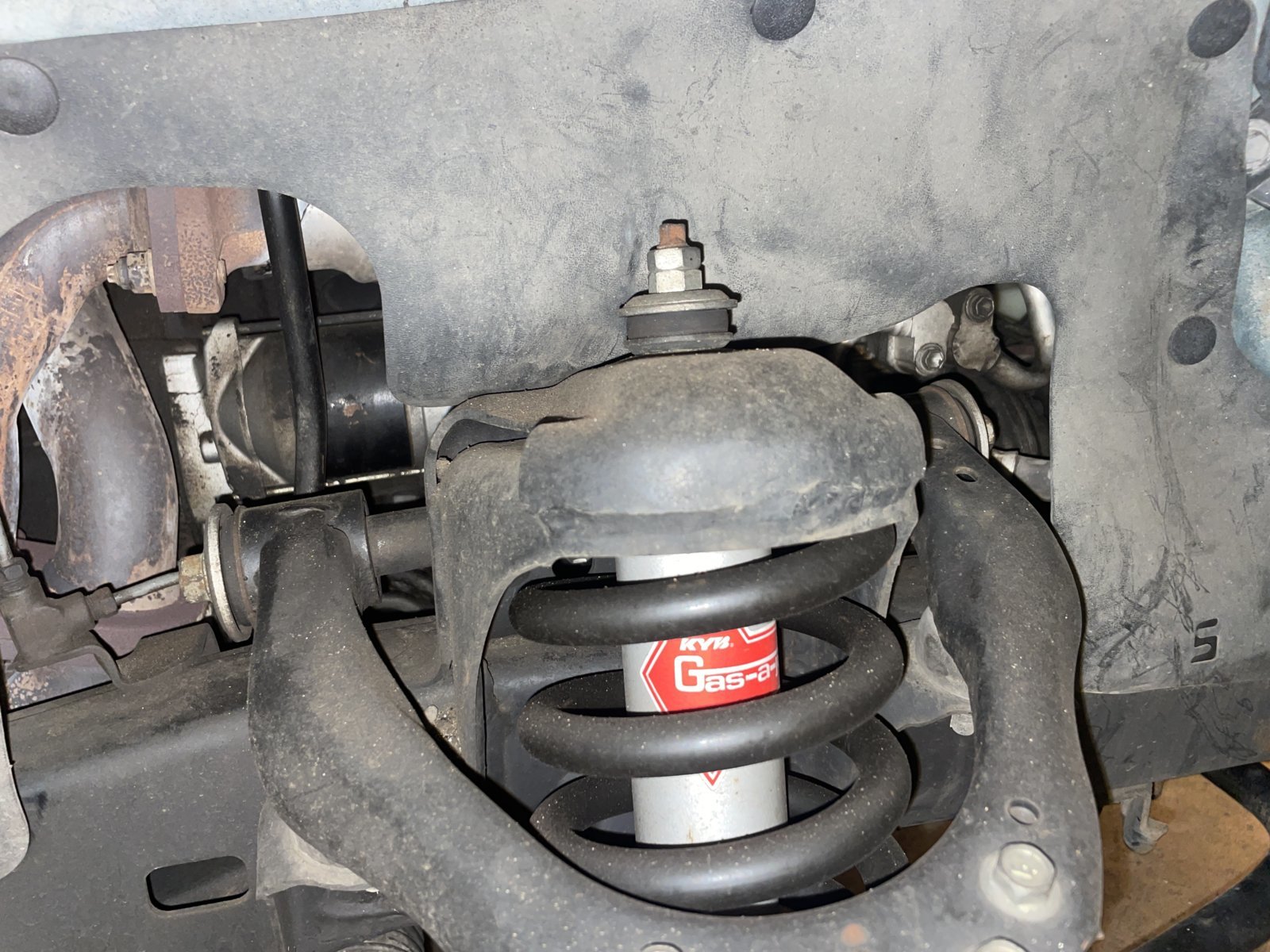

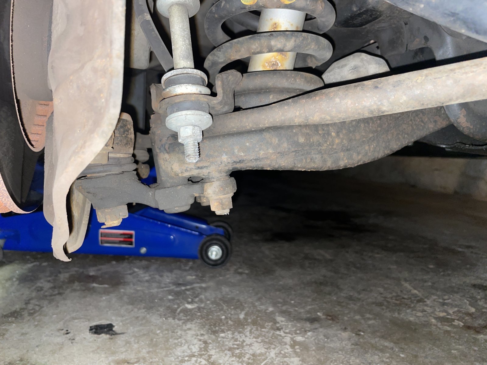

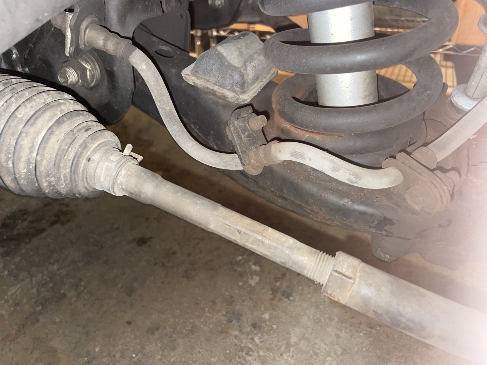

    How does the coil spring procedure differ for a 1st gen 2wd 5-lug? It was mentioned a couple times in this long thread but some links and pics are gone.
    The FSM basically has this procedure plus more steps after, which seems to be oriented around removing the LCA to replace LCA bushings.
    1. remove shock
    2. compress coil spring
    3. remove stabilizer bar
    4. remove LBJs and LCA
    5. remove strut bar
    6. remove coil spring
    I don't know that means removing the LCA and LBJs is necessary for the coil spring to come out? I don't want to do those. Does compressing the coil spring the right amount lift it off the LCA so it can come right out?
    Here are pics of passenger side.
