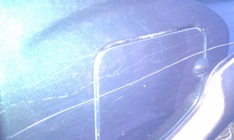

    Everytime I go to the mtn I add another one to the list. There verry minor and I'm sure can be taken off . My Tacoma is black so most anything shows in the sun.
    So what's the best way to get rid of them?

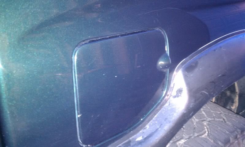

    Buy a 3m scratch remover kit. Got mine from walmart. Comes with 3000 grit sandpaper, rubbing compound, and polishing compound. And 2 foam attachments for a drill. Most scratches are only clear coat deep...so usually pretty easy to fix. Here's a before and after from my last weekend trip. Still have lot more scratches to do lol.
