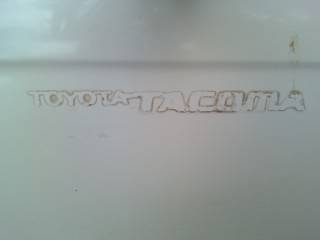

    how do i get this off. i have tried goo gone.

    sand blasting would most likely work.

    not too sure thats that will come completely off without leaving a shadow,....been there a while. best thing to try....some spray adhesive removed...spray and let it sit for a while...keep respraying it every so often.

    Heat gun, wd-40, or mineral spirits...
    NM heat gun is probably how you took the emblem off, I know wd-40 does the trick getting sticker adhesive off of windows....

    some bug/tar remover and elbow grease...possibly fingernails

    hair dryer + goo gone, or try some paint thinner but be careful

    some wet sandpaper
    j/k. not sure. try a hair dryer and then some goo gone again. purple power maybe?

    i figured it out i sprayed it down with some wd-40 and someone on another thread told me about using a plastic spatula to scap it off it works like a charm. I can barely tell its there ill wax and polish it down tomorrow.
