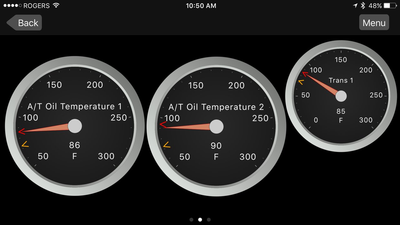

    Hi Larzzzz. The toyota pid for tranny temp is exact to the formula - I was playing around with them yesterday. In the pull down menu the tranny remps are near the start of the list. I will post a screen shot in a few minutes.
    Here is a shot of the toyota pids and the one I programmed. The programmed one is on the right.[/GALLERY]

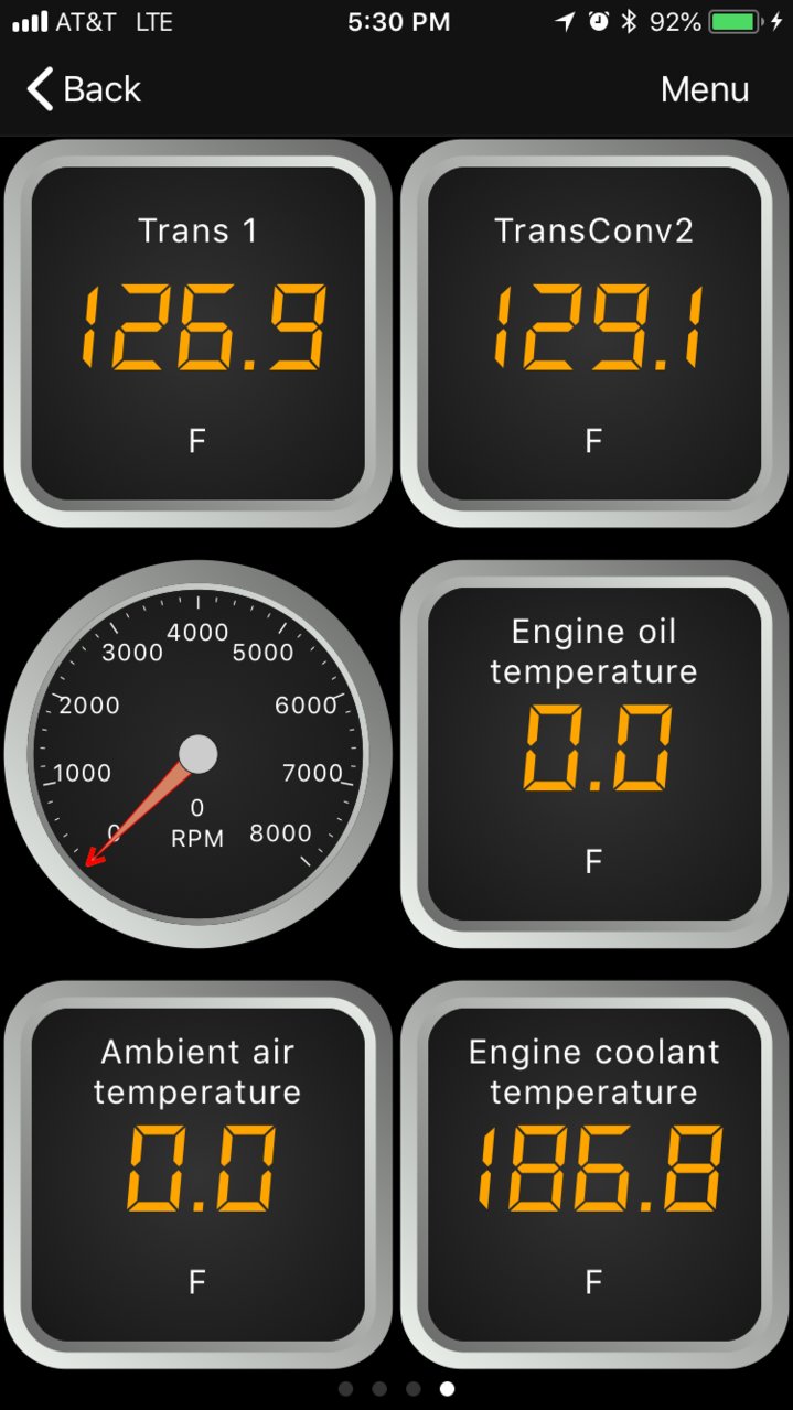

    Just downloaded the Fusion app and added this PID and hooked it to a gauge on the display. So far, so good.
    Hopefully it will work when I connect to my ODB II reader in my truck at lunch!

    Works like a champ! After 15 min drive:

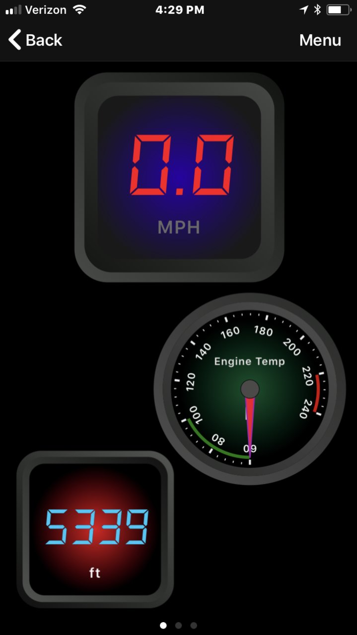

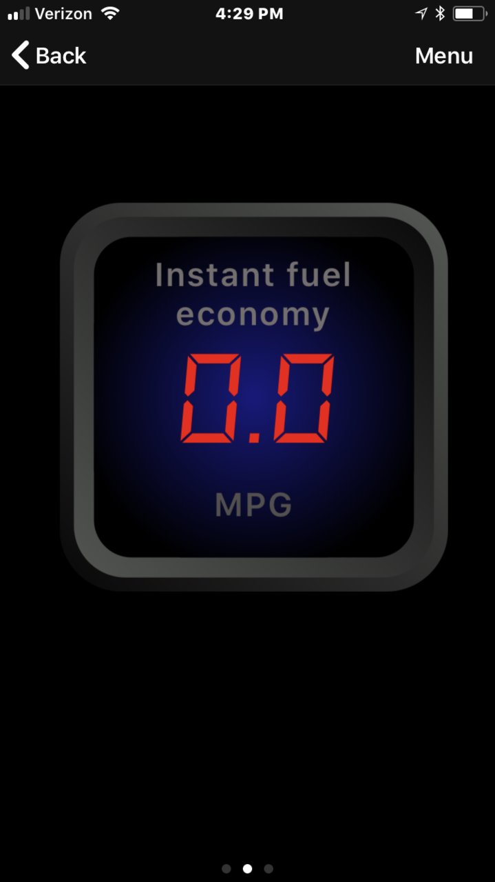

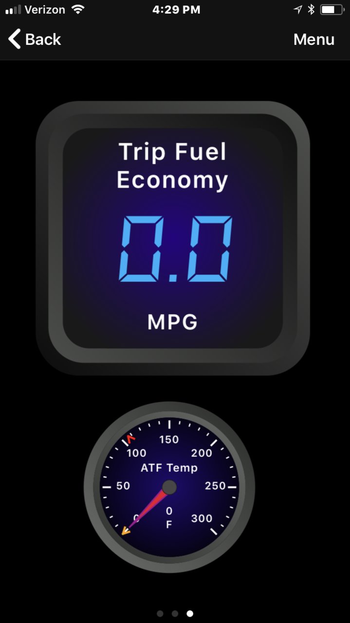

    Just added to the one of my dashboards. Looks to be working. Thanks for this! Save me some money. Curious how accurate the fuel economy is? Wish there was a sensor for remaining fuel...

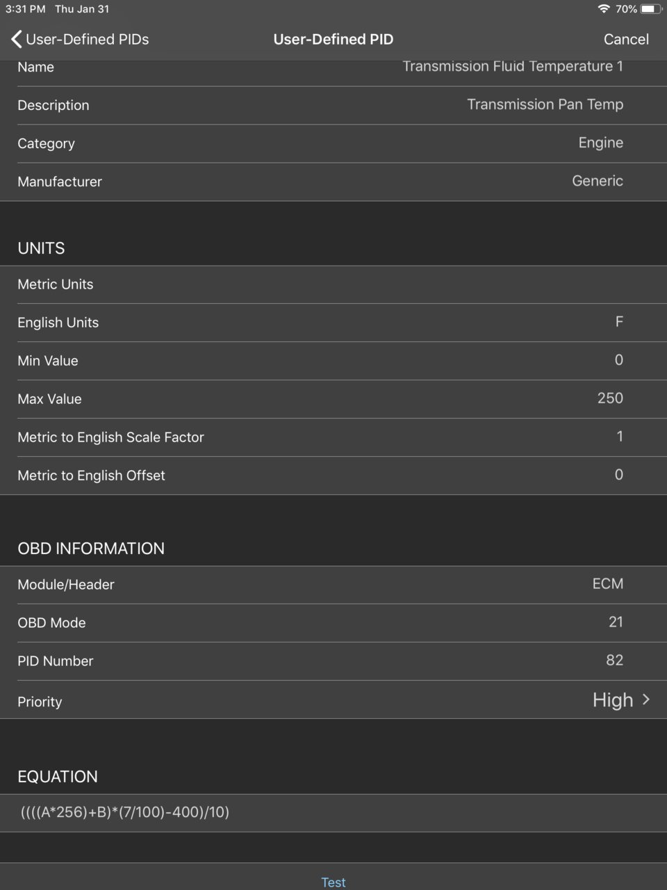

    Ugh, no worky... yet. Have fusion app on my iPhone and entered the formula but get no reading.
    I got the regular $10 fusion app.
    Do I need to buy any add ons?

    I use regular $10 Fusion with iPhone, works perfect. Double check your formula against this:
    TireFire[QUOTED] likes this.

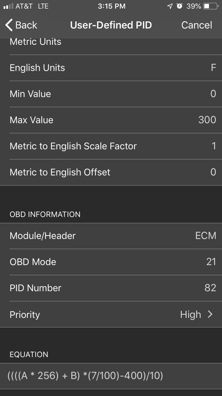

    Here’s the forumula for torque converter temp
    TireFire likes this.
