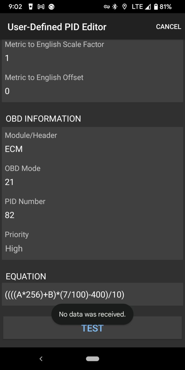

    I have been trying to get this to work with no luck. It only says "no data received" when I click test. I've been trying to find a solution with no luck. Also tried two different OBD scanners and two different apps. I know it's supposed to work so not sure what I'm doing wrong.

    Maybe change A and B to C and D and see if it reads anything?

    Thanks. I did that too. Same results.

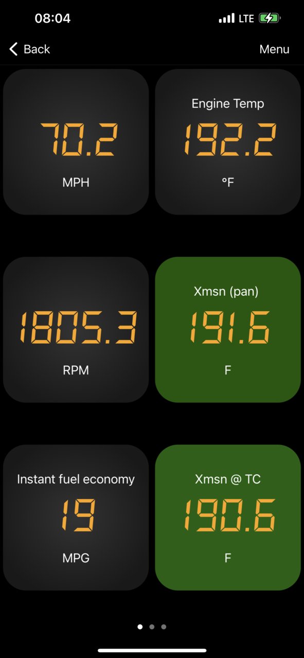

    From another thread:
    Name: Transmission Fluid Pan Temperature
    Description: TF1 (pan)
    Category: Engine
    Manufacturer: Generic
    Units
    Metric Units __
    English Units: F
    Min Value: -40
    Max Value: 350
    Metric to English Scale Factor: 1
    Metric to English offset: 0
    Unit Type: F
    OBD Information
    Module/Header: 701
    OBD Mode: 22(*)
    PID Number: 1627(*)
    Priority: High
    Equation: (A*459/255)+(B*1.6/255)-40
    Name: Transmission Fluid Post-Converter Temperature
    Description: TF2 (conv)
    Category: Engine
    Units
    Metric Units __
    English Units: F
    Min Value: -40
    Max Value: 350
    Unit Type: F
    OBD Information
    Module/Header: 701
    OBD Mode: 22(*)
    PID Number: 1628(*)
    Priority: High
    They work for me. Make sure that spaces are removed. Or just buy the $15 Toyota add on for the year of your vehicle.
