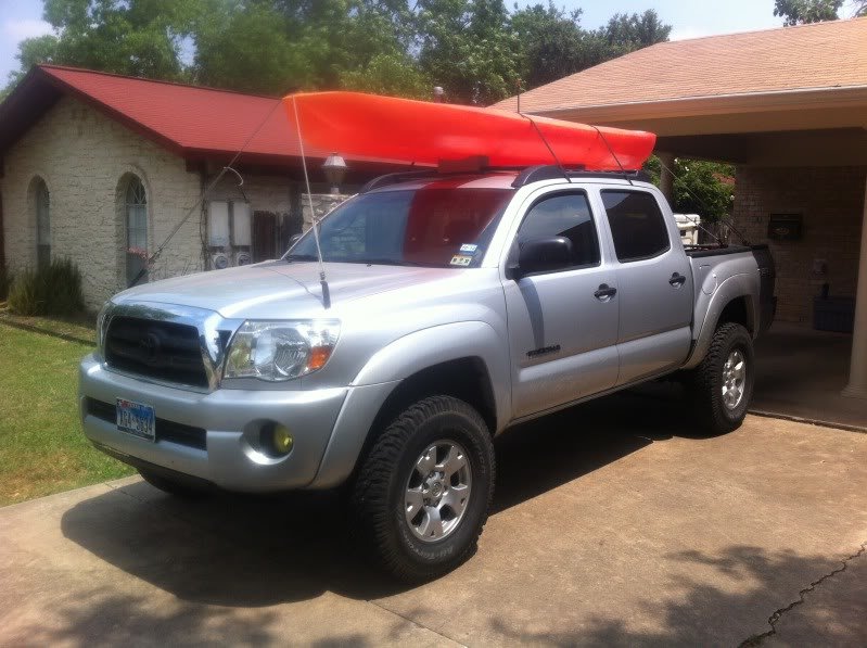

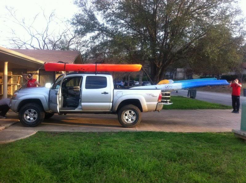

    This to go down to the coast:
    or
    this to go down the street to the lake:

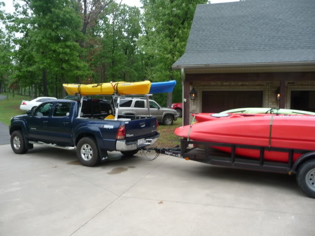

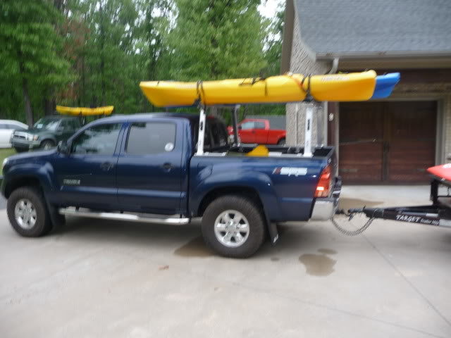

    Tracrac FTW.
    My 12' and another 10' on my rac. Several on the trailer.
