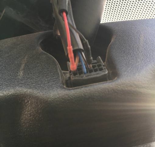

    Nice im going to try this.... the HERO 5 has the new USB C so I purchased the female end so I can just use the plug that came with the go pro..... how did you splice it? solder? does it just tuck into the same conectors ? I see the guy on the thread used a Mirror Tap?

    Was going to solder it, and almost went with the taps like the picture, but in the end decided to use Posi-Taps inside the headliner area. I then secured the small power converter and wiring using some double stick foam (the kind used for windows/doors) to prevent any rattles/noise.
