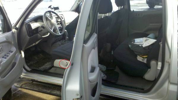

    How do I remove this knob circled in red? I tried just twisting good ol lefty loosey but I didn't want to force anything.
    Sorry about the crappy pic but it is what I have and gets the point across.

    should have a metal clip behind the handle

    x2..probably some kinda jesus clip

    Thanks guys I appreciate the prompt response. Gonna get my plastidip on again tomorrow ;)

    i think it looks like this [​IMG]

    Still having trouble with this... :( room behind the panel is very limited

    Just pull it straight out. I removed mine due to it causing a wear spot on my seat. Just pull.

    WOOHOO! I got it! cc350 gave me the confidence to pull! So I pulled and it poppedo out a little, where I could see the clip that looked like the picture honda posted! done and done rep added!
