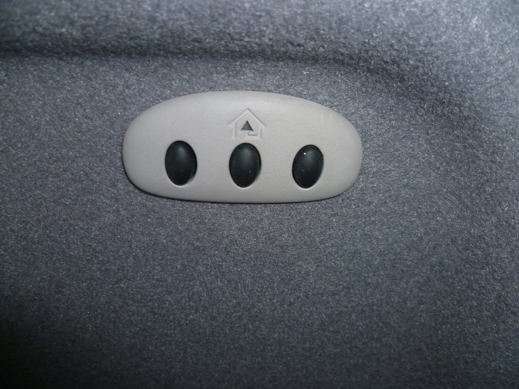

    Tired of having my 2 remote controls (one for the gate and one for the garage) laying around the center console or looking for them inside the center console and frustrated with Toyota design that offers a homelink OR a temperature gauge, I guess that for Toyota if you have a garage opener you don't have to worry if it's hot or cold outside :p, anyway. I went to ebay and got an used rolling code garage opener.
    this one:

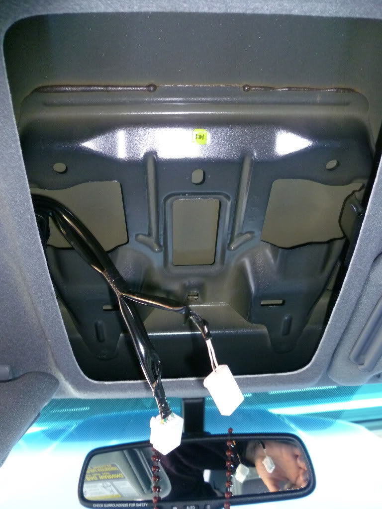

    took the front out
    removed the overhead console

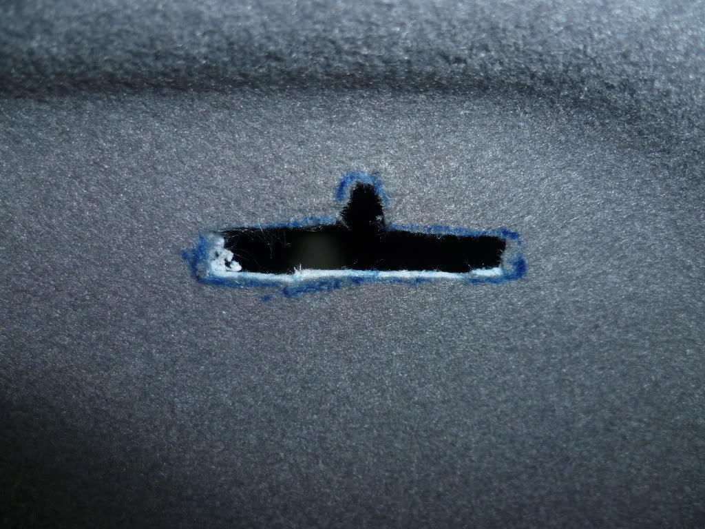

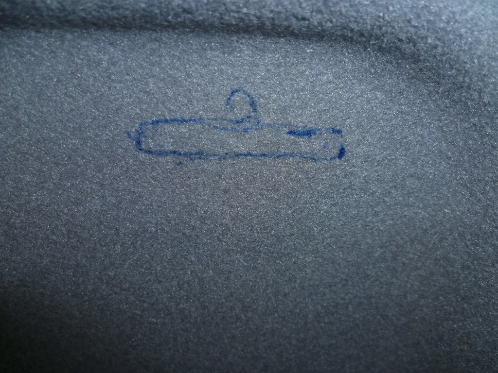

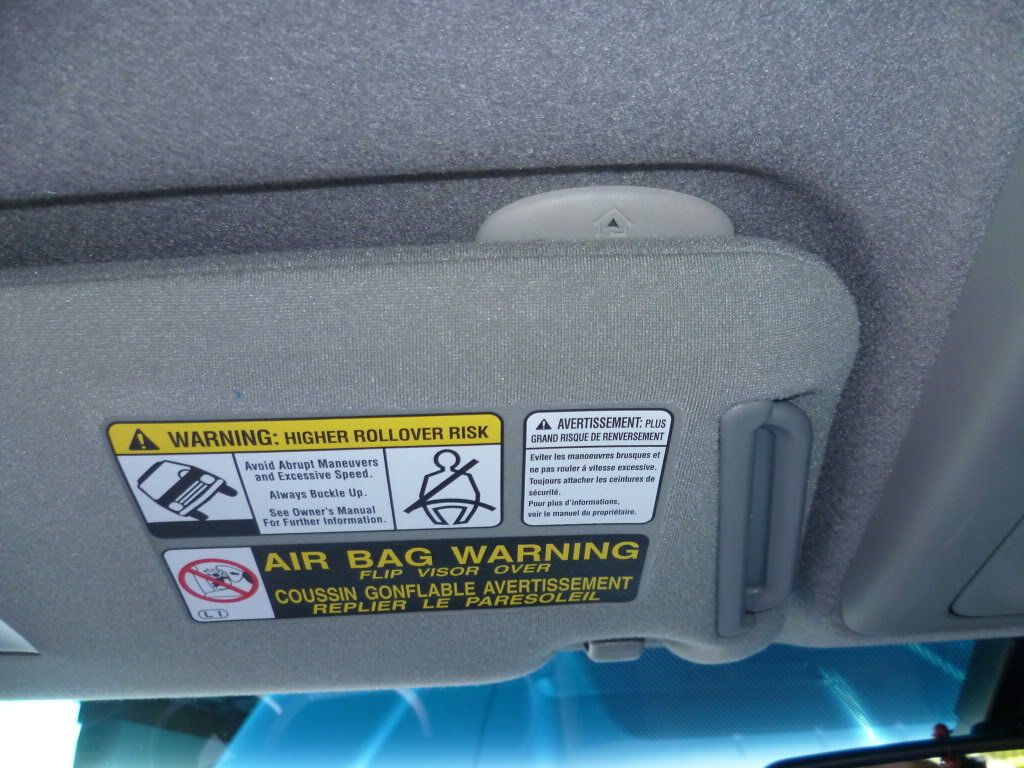

    looked for the best place to install it, I wanted it exposed, but I couldn't, it was going to be to far toward the center of the roof. So I settle to install it behind the sunvisor, marked with pen
    cut the opening with a razor nife
    clipped the front of the remote back in place
    pigged tail the power from the overhead light (the smallest plug)
    and that's it
