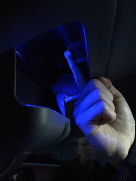

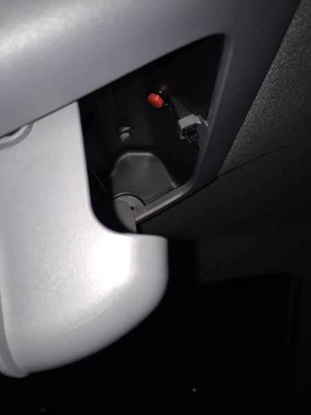

    my son's. I wired a LED to flash when the button is pushed and right now it is only on with ignition on, even though it is hidden away.
    Top 5 interior mods in my opinion.
