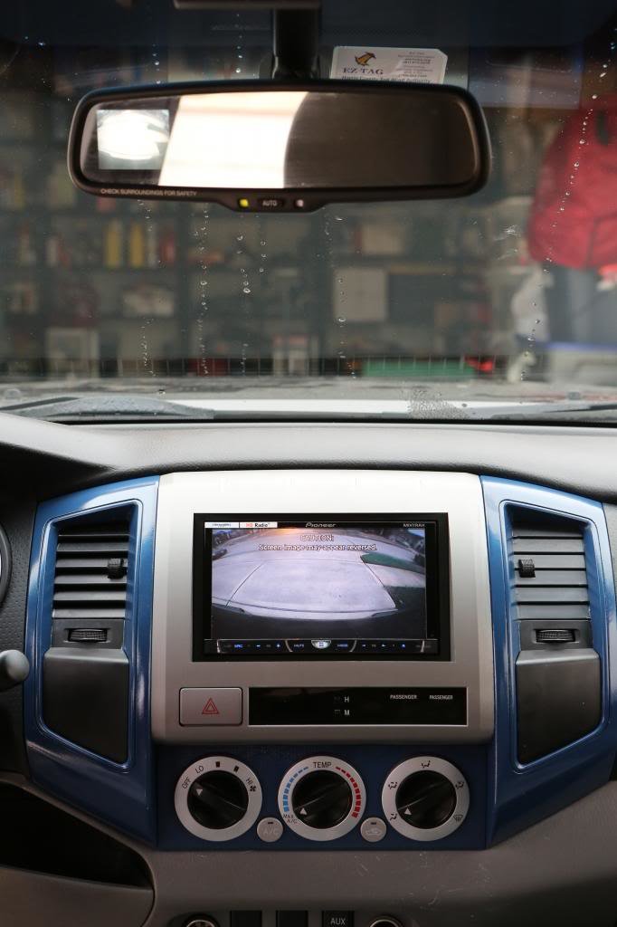

    Wow, everybody has been busy!
    Looks like some SWEET setups :)
    Bluedegeon, I ran the redblack wires to my left tail light and used the reverse lights 12V wire.
    So now whenever the reverse light gets power so does the camera.
    Also, be sure to setup the radio!
    In mine it didnt display until I set the Camera Polarity setting to Battery rather than Ground or None.
