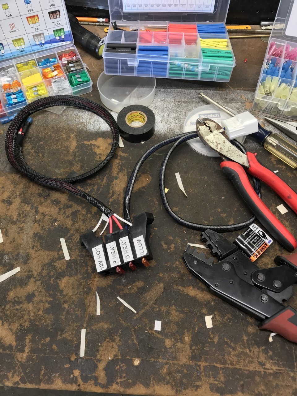

    Would you mind/be able to show a pic of what the wiring looks like? Just can’t decide how I want to wire mine heating elements/switches.

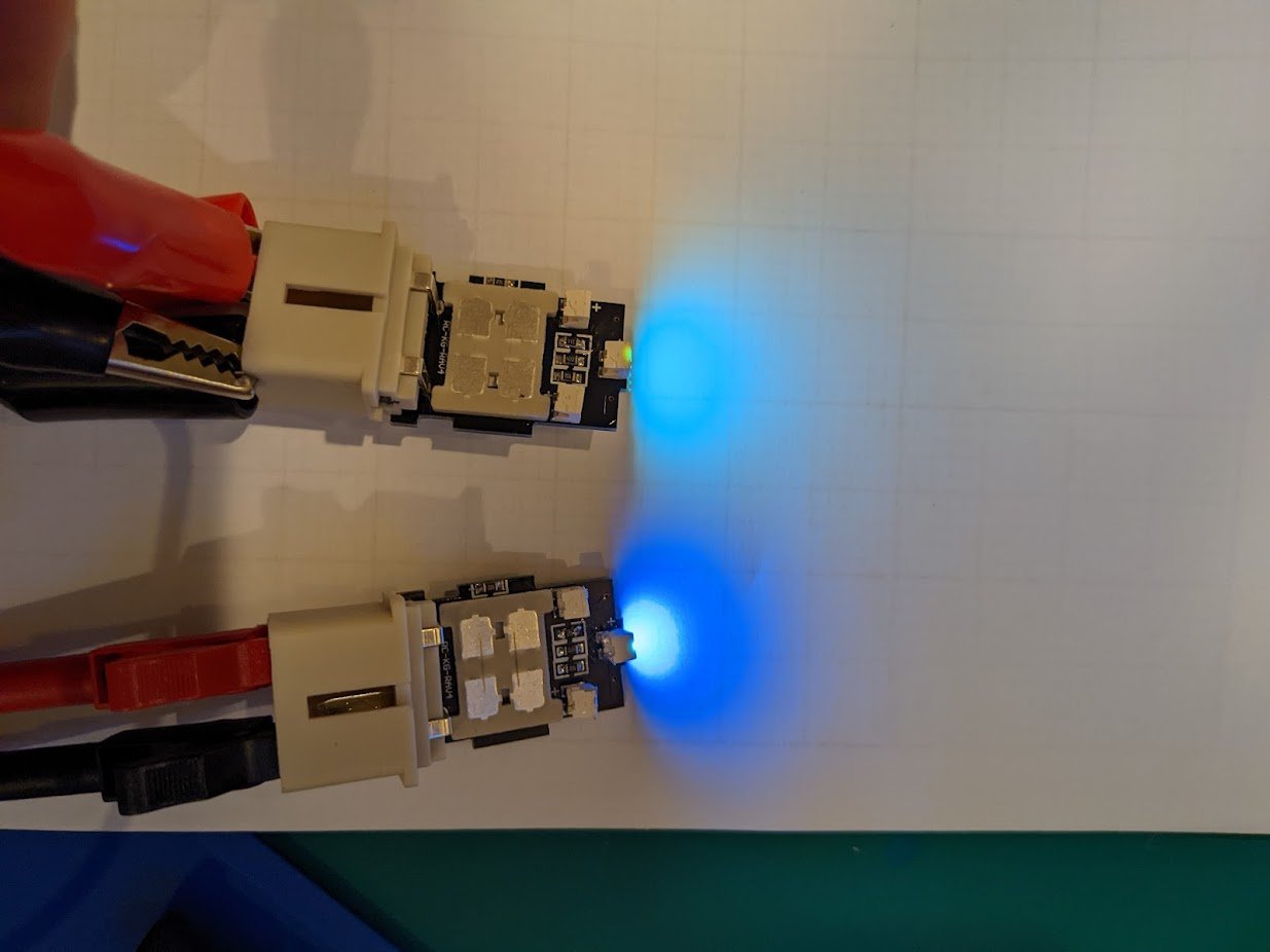

    They are. Right angle LEDs and soldered on. I have two sets of these switches have been playing around with them. I found the blue to be a tiny bit lighter in color than the factory blue so I soldered in new blue LEDs but they are too blue so I'm going back to the original and will put in the green at the same time. The photo below is what the inside of the switches look like. The light blue is the aftermarket factory, the darker blue is a replacement LED but it is too dark.
