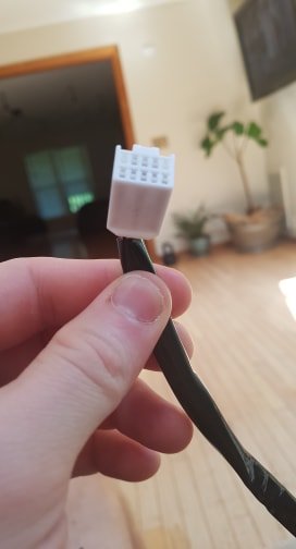

    Here's a long shot - anyone know where I could find a harness extension for the besond switches (or the part name so I could make it if necessary)? I'm waiting to hear a response back from them on Amazon.

    I'm also looking at the S/HTR 20amp fuse and thinking this should work for the heated seat kit. Even if powered all the time the kit has a relay that will be run to switched power. Did you end up using S/HTR? Would make this much easier than going through the firewall.

    You can cut the wires and solder addition wire in.
