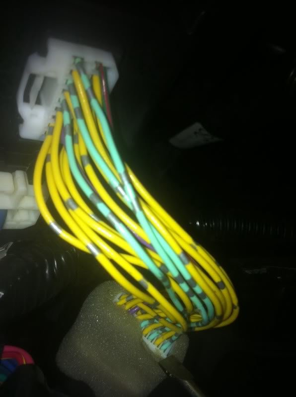

    Hey guys, I'm looking for a little help finding the sending unit for a compass. I just ordered an overhead console, but before I did I made sure I had the wires for the compass and temp behind the console. I was just reading the write up and checked my truck for the sending unit wiring behind the radiator. I looked everywhere, and found nothing.i see the wires behind the horn, but no plug. Is there somewhere else I can look? Or how would I add my own wires? Thanks.

    #80
    adio
    adio Well-Known Member
    Sep 11, 2008
    #9165
    2,637
    HI
    2015 INFERNO TRD PRO
    also had the same problem as you. I didn't have a plug for the ambient temp sensor. ended up running my own wires from the 1C connector. check your 1C connector. located on the fuse box driver side. the connector is right next to a red fuse. check pins 1&3 top left-down. if it's not connected to anything that means you just have to run your own wiring.
