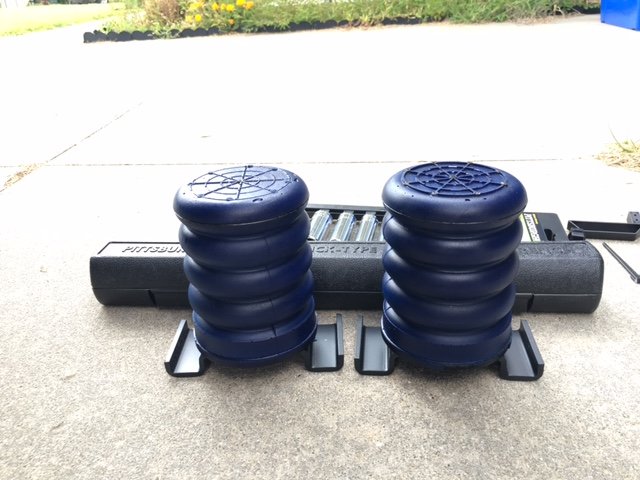

    Tools that are needed:
    Sumosprings (I hope you have these before trying to install them)
    Jack to lift rear of truck
    1/2" drive socket wrench
    1/2" drive torque wrench
    19mm deep socket
    Nice to have as well:
    Jack stands (for extra safety)
    Wheel chocks to stop the front end from rolling backwards/forwards once you lift the rear end
    Beverage of choice
    Radio
    Sumosprings are designed to replace your factory bump stops to avoid your rear end from sagging while towing. What these things look like in case anybody isn't familiar with them.

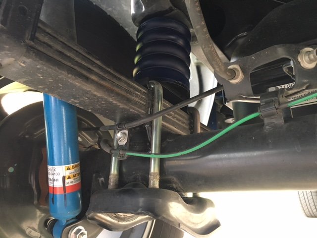

    -First thing you want to do is to crawl under the rear end of the truck and locate the two brackets that your u-bolts are connected too. These will be on the underside of the rear axle, one on passenger side and one on drivers side.
    -Once you find these brackets. Use your 19mm socket and 1/2" drive wrench to loosen the nuts on all of the u-bolts. You don't have to completely remove the nuts, but you can loosen them as closely to the end as possible. Doing this will allow you to remove the old bump stops and install the new springs without actually taking the u-bolts and plates completely off.
    -Now that these are loose, you then can jack up the rear of the truck. You don't want to raise it by the axle or pumpkin. It's better to raise it by a point on the frame such as the bottom of the hitch. Doing this will release the tension of the leaf springs from the axle and create a little more room between the axle and frame. If you lift by the axle it will actually compress the space between the two a little more making it difficult to add the new springs in.
    -Once it is lifted up, place your jack stands if you are using them.
    -Crawl back under the truck and you can push the bottom of the bracket to lift the u-bolts from around the old bump stop. Once the old is removed, simply place the new sumospring where the old bump stop was. Make sure that the u-bolts are actually holding down the spring and not beside the bracket.
    -Tighten the u-bolt nuts in a star like pattern snugly at first. Once they are snug, finish them off with your torque wrench to the proper torque setting.
    -Repeat the same process for the other side.

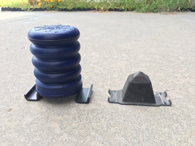

    Comparing what the factory looks like to sumosprings.

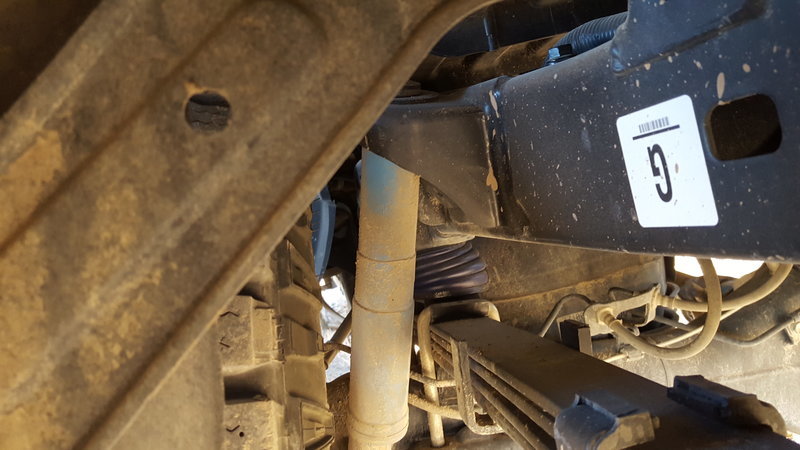

    Here is a picture of the compressed height of the summos.20160625_071442.jpg
