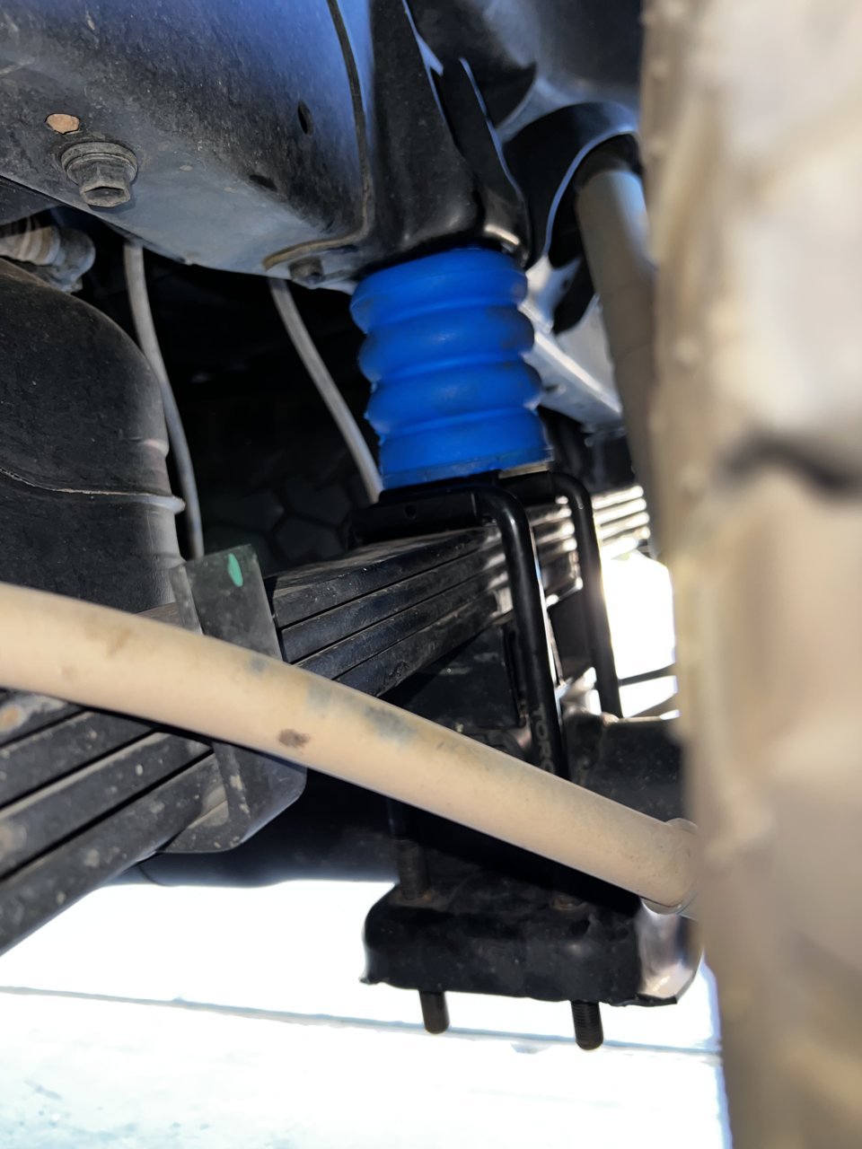

    i installed them on mine about 1 1/2 years ago and there is still a small gap between them and the frame..really didn't raise the rear end but really helps with loads..
