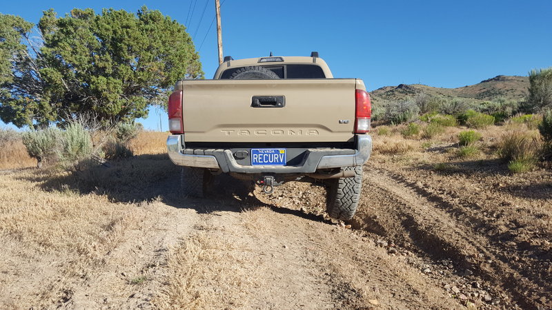

    Just so everyone knows the offside wheel was off the ground when I took this photo. I assume the summo spring was stopping the articulation but it could have been the shock on the other side bottoming out.

    So according to the supersprings website the sumosprings compress about 50% of their height, that is of the blue material, not the total hieght. Your pic seems to support this @nevadabugle . With a standard lift provided by a dakar leafpack I wonder how much of a gap there would be between the sumo and the frame. It would seem that the compressed height would be about 2 inches taller than the factory bumpstops.

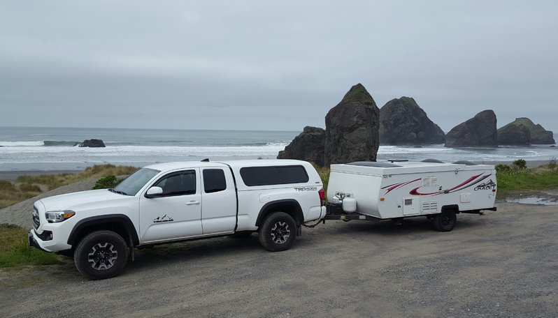

    I think I'd discourage the heavier SS; they're for the Tundra. If you put them on the Tacoma your rear end would likely be VERY high, and ride quite stiff.
    I've had the SS40s on my '16 TRD Off Road for about 6 months and 5000 miles and am very happy. A snap to install. Truck has Snugtop cap, and 100lbs of gear in it full time, very slight lift in the back, no noticable change in ride.
    Camping: 275lb tongue weight, 2400 lbs of Chalet A frame trailer, couple hundred pounds of gear in truck + dog... Truck is near level, no squat.
