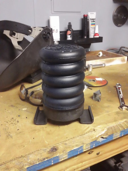

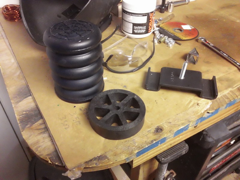

    If your rear is lifted, they make spacers. You have to call sumosprings direct, I don't think they advertise these. You need longer hardware. These are 1" thick and I think they have other options. I am running Icon AAL and I wanted to close up the space to contact point to make up for the taller leafs. Of course, I can't say how I like them since I haven't installed them yet!
    Hope this information helps someone.

    Thanks for sharing!

    Excellent. Yes, most definitely useful information.

    I would recommend no spacer on lifted apps. That way you have an inch or 2 of suspension for the small bumps. When you load up, these don't squat much for those who don't like the desert truck look. This way your ride will be enjoyable in both scenarios.
