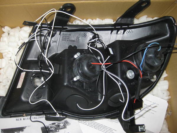

    -I have these same head lights. Make sure you throw some electrical tape around the 3 little LED lights. They vibrate out of their hole, bang around and the bulbs break! Plus if your out muddin' and this happens, its a direct hole into the head lamp and mud will get in there and RUIN YOUR LIFE! I know cause it happened to me :( They look good though!

    Trying to install halo/led what wire is positive on truck light

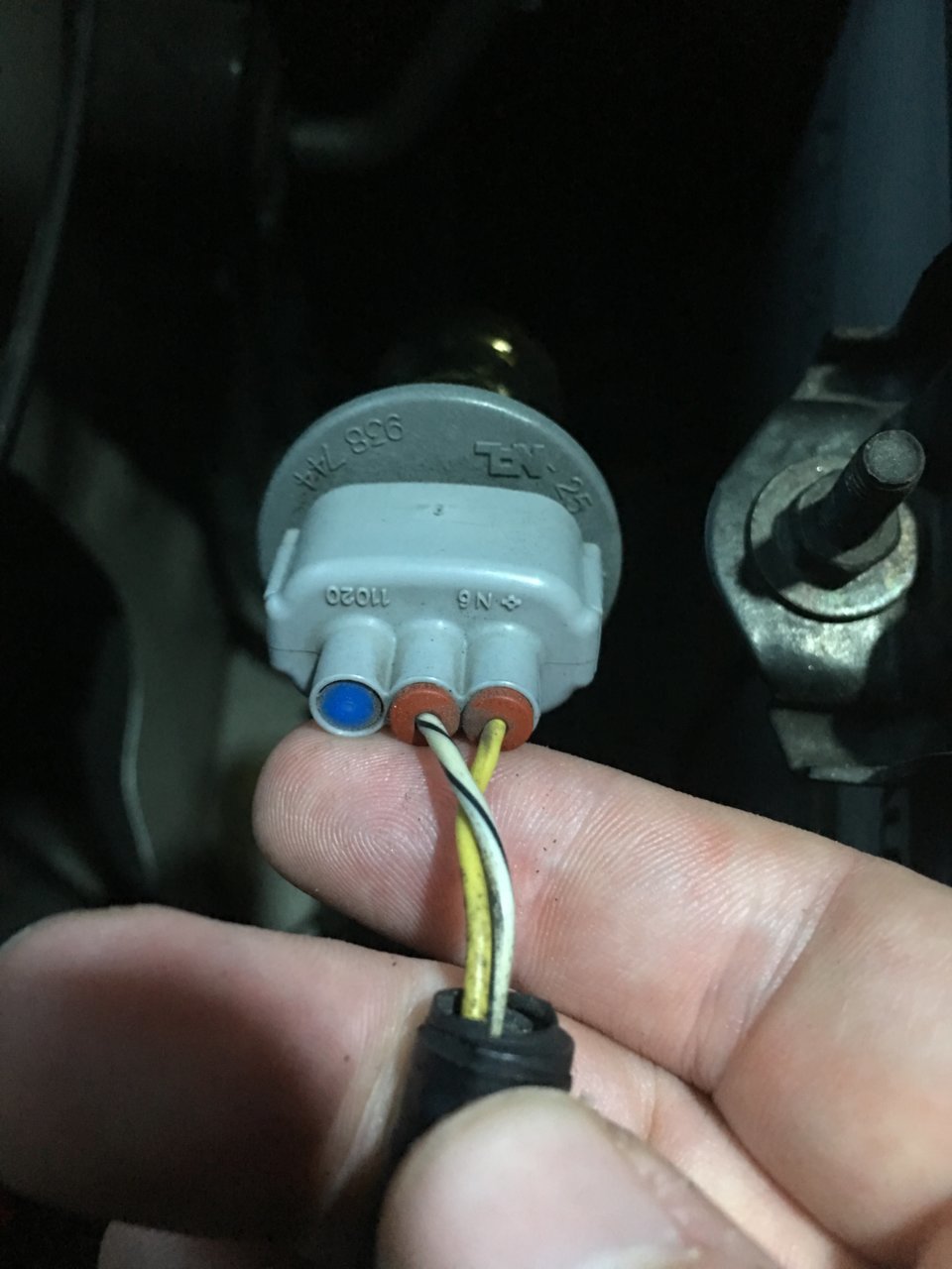

    So what wire of the two on the parking lamp did you connect the positive to? And where did you connect the negative wire?

    @lancewood
    Did you ever figure out which is positive and negative? On my running lights I have one green wire and one white wire with a black stripe and I don't know which is which been searching all morning!

    I connected the led and helos to the marker light. That way you can trun on and off when you like

    @GentlemanGinger
    On my headlights there are three pigtails on the lights, one from the leds, one from the blinker and one from the halos. The leds do not blink with the blinker. I’m away for the weekend. Can you post a pic of your wires? I’m away for the weekend so I can’t look at mine now but I’ll try to help when I get back. I also have the wiring diagram for the 05-09 second gen if you think that would help.

    So I’m looking at 2 wires. I’ve checked with volt meter probes and one is obviously ground and the other is constant current until I put on the blinker. I really don’t want to have blinking halos

    What I did was I tapped my halos and leds into my parking lights, which should be separate from your blinkers. That way you can turn on your halos/ leds as running lights and also they will come on by default when you headlights are on
    @GentlemanGinger

    That worked perfectly

    When you attached the wires to the parking lamps were they the same color going in to both? Or how is that done?
