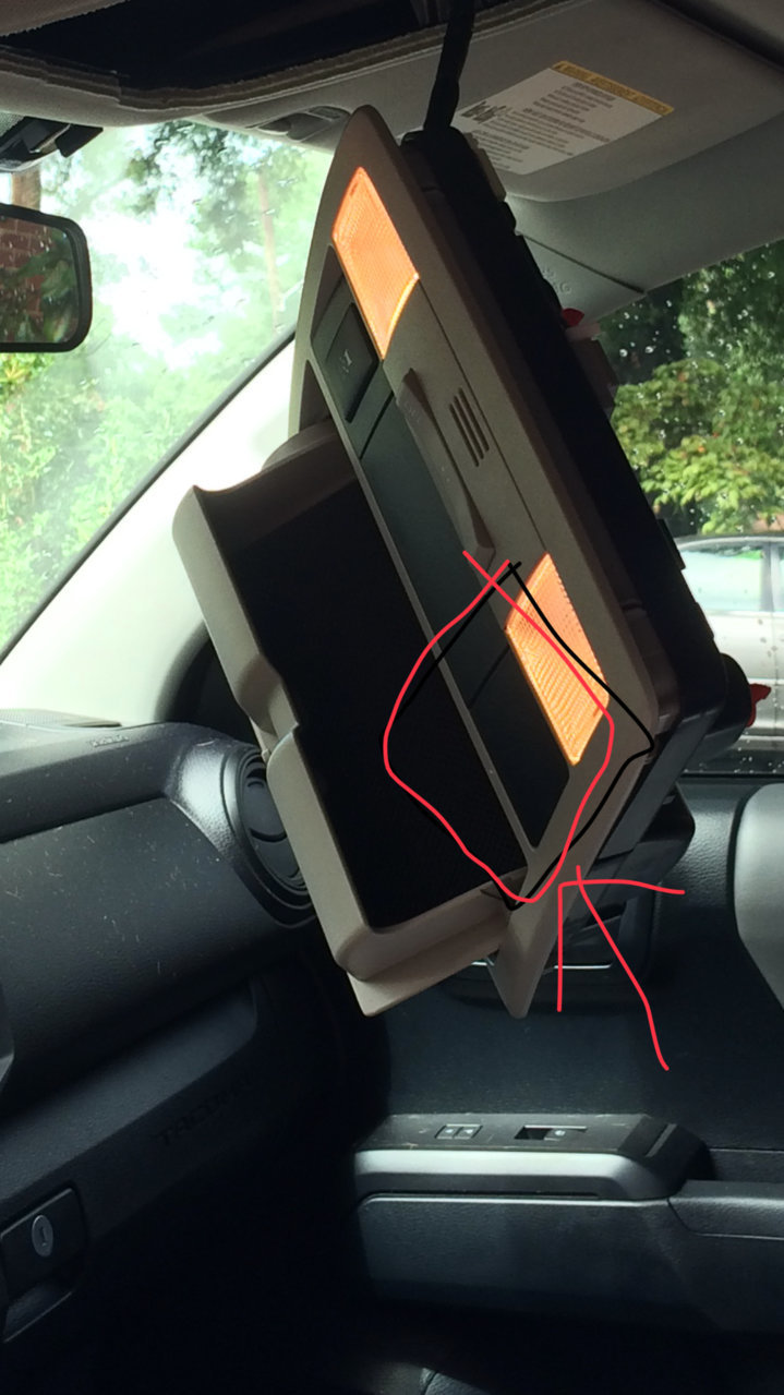

    Is your traction control button on the left side up there? If so, on the other side across from it I have just a little plastic cover covering the hole for a blank switch and that little cover rattles
  10. Aug 7, 2018 at 9:14 PM
    #30
    brodys16sr
    brodys16sr Well-Known Member
    Apr 24, 2016
    #185194
    60
    Brody
    Charlotte, NC
    2016 metallic tacoma sr double cab
    (That photo was for insurance when tree fell on roof, which is why it’s hanging by harness)
